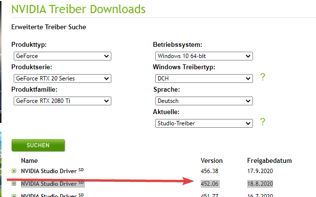

I had great problems installing the ultiam version of Win and nvidia driver I had to format the PC at the end
After formatting the PC from scratch, I used the DDU to clean the nvidia driver installed by windows and installed the following driver;
But you seem to have some problem with Open GL and I had to dowload a cuDNN file...
can you give me a hand with that?
Which OpenGL drive do I have to download?
Did I download the right Nvidia drive?

Hello samsue,
I'm testing 456.38 studio version and it seems to be ok wiht my RTX
https://us.download.nvidia.com/Windows/ ... h-whql.exe
Said that try as follow:
1 Updates windows 10 up to at least build 1909 or 2004.
2 Right click the Start button and select Control Panel.
3 Make your way to System and Security.
4 Click System.
5 Click Advanced system settings from the left sidebar.
6 Select the Hardware tab.
7 Press the Device Installation Settings button.
8 Choose No, and then press the Save Changes button.
9 Unistall the Nvidia drivers using DDU Nvidia unistaller drivers (**safe mode unistall** - [windows safe mode](https://support.microsoft.com/it-it/hel ... -safe-mode))
10 install the Nvidia driver "studio driver". Please doesn't install GeForce Experience and make a clean installation.
Having some trouble downloading, you can download the cuDNN library from the following link:
https://render.otoy.com/downloads/e5/c5 ... nn64_7.dll
Then place it in C:\Users\<user name>\AppData\Local\OctaneRender\thirdparty\cudnn_7_4_1"
