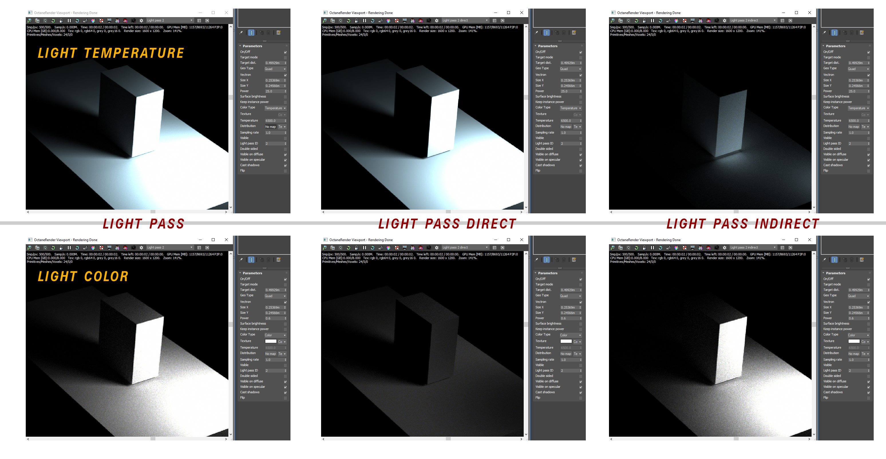

Why theses difference between temp light and color light ?
HHbomb
Posts: 1434
Hi. I wonder why ? (see pict )

I think it`s correct, the temp lightpass is set to 6500K right? If you work in linear it`s a bit blue-ish.
The colour lightpass is just plain white.

Hi,whersmy. Thanks to point it at to me, but what I find annoying is the difference of intensities in light passes.

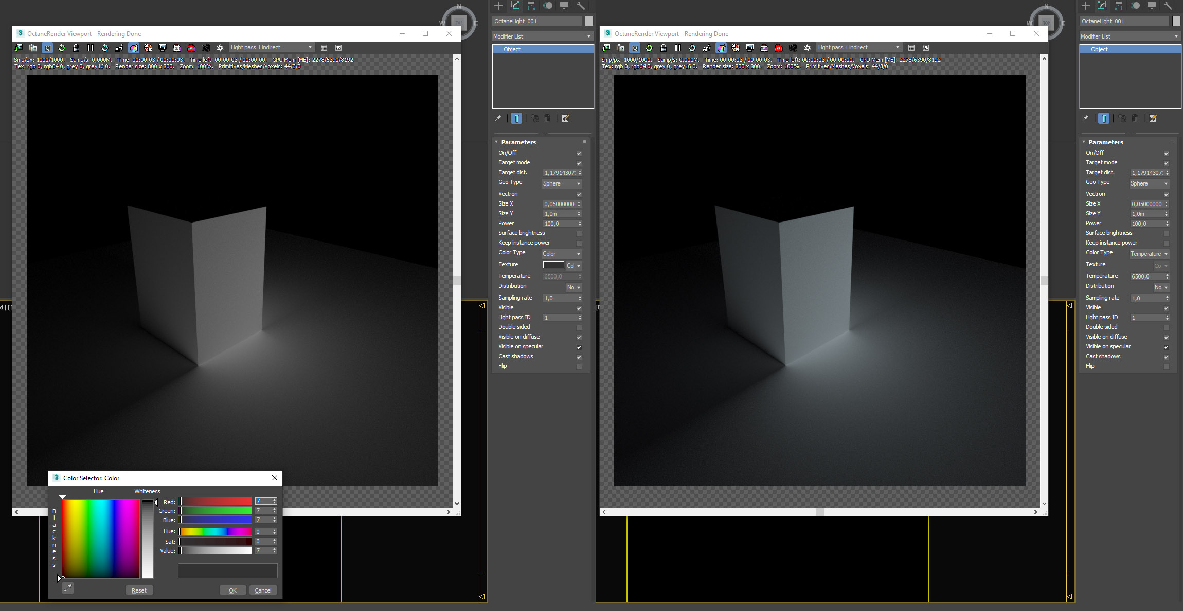

leaving asaid the dominant color, which is a known matter, it depends on efficiency value.
1 has to be 0,025 then 6500 kelvin in RGB is not 255 but around 7.
