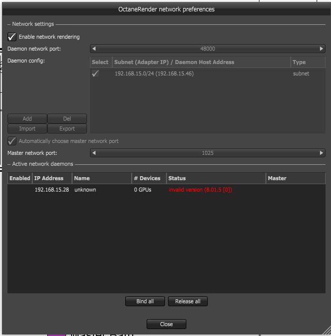

I have version 2020.1.0.65 enterprise edition for Revit 2019 installed on 2 machines and I am unable to network render.
i guess my question is which version of network daemon do i need (tried 4.02.1 as well but still says invalid version)
Could you please help.
thanks

Hi.
You need Octane Standalone 2020.1.
Paul

I have installed 2020.1.5 enterprise standalone and then installed the daemon 2020.1.5 as well but still says invalid version (8.01.5 (01)
Still no good
what might i be doing wrong?
edit
Also tried standalone and yes the network render slave is seen as available but not when I am on Revit octane

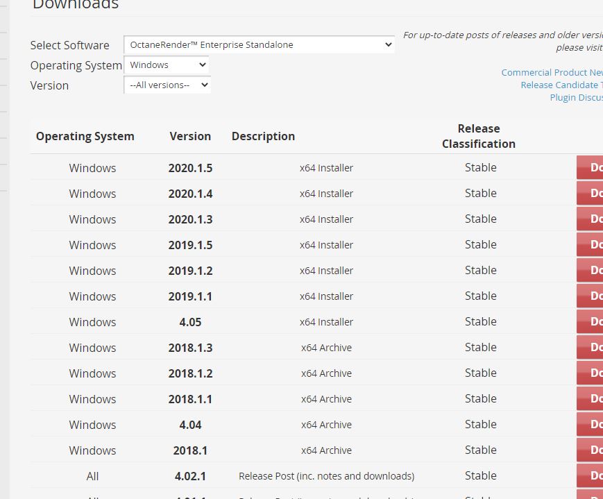

2020.1.5 is a different version to 2020.1. You need just 2020.1.

sorry to be a pain but these are the ones available and there is no 2020.1

Thanks Paul
it works now
