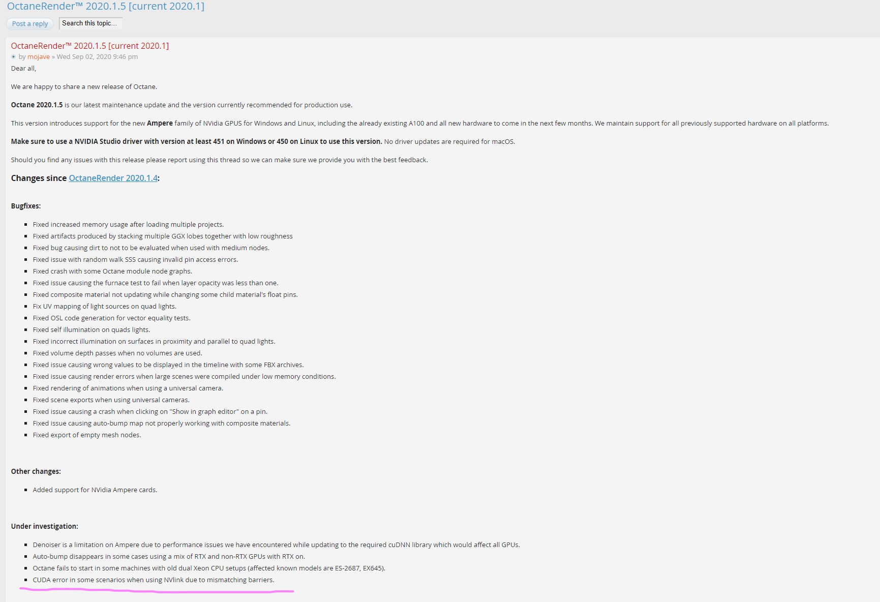

I've not found NVLink to be very useful in Octane (yet) In scenes where I could max out physical vRam, I would get regular Cuda/Optix errors when rendering with NVLink enabled.
In the latest 2020.1.x builds the developers have acknowledged this issue and have marked it as "Currently Under Investigation" It is really helpful for them to communicate this in my opinion:
