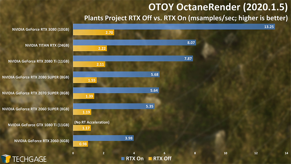

Primarily what I want to know is whether this blue bar gets doubled with two cards or not. :shock:

newer version of OctaneBench is available now.
the 3080's score is 566,
if as usual, 2x3080will be arround 1132
https://render.otoy.com/octanebench/res ... owRTXOff=0

I would wait and see if there is a 3080super or 3080ti which is rumored to be 20G Vram,
and hope it would be blower type.
the strugle with 2x3080vs 3090 is understandable, anyway it will be similar price but big OB difference:
2x3080:1115OB vs 3090:most likely700OB, it is big difference
