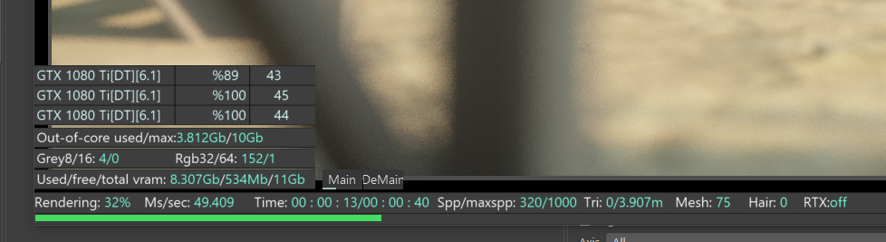

I have 3x1080tis which are 11GB, and yes before you say it I know it doesn't use the the combined memory and all that. But I've barely got any assets in the scene, I have so much more of the scene to build out and I've ALREADY reached the point where I only have a few hundred MB left in GPU memory. It's basically made it impossible to get any further!? If I add anything to the scene now it just crashes it so I'm royally screwed!

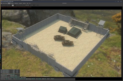

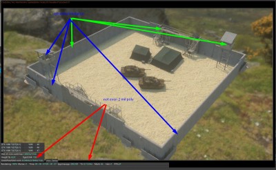

Here is the scene in the LV:

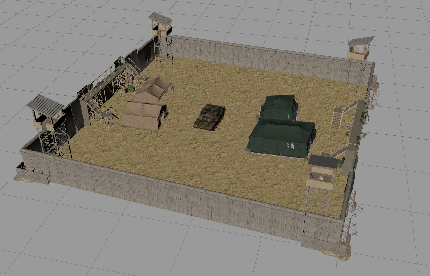

And this is basically the scene which is barely any assets:

Textures are barely anything, few MB each AND I have out of core set to 10gb...

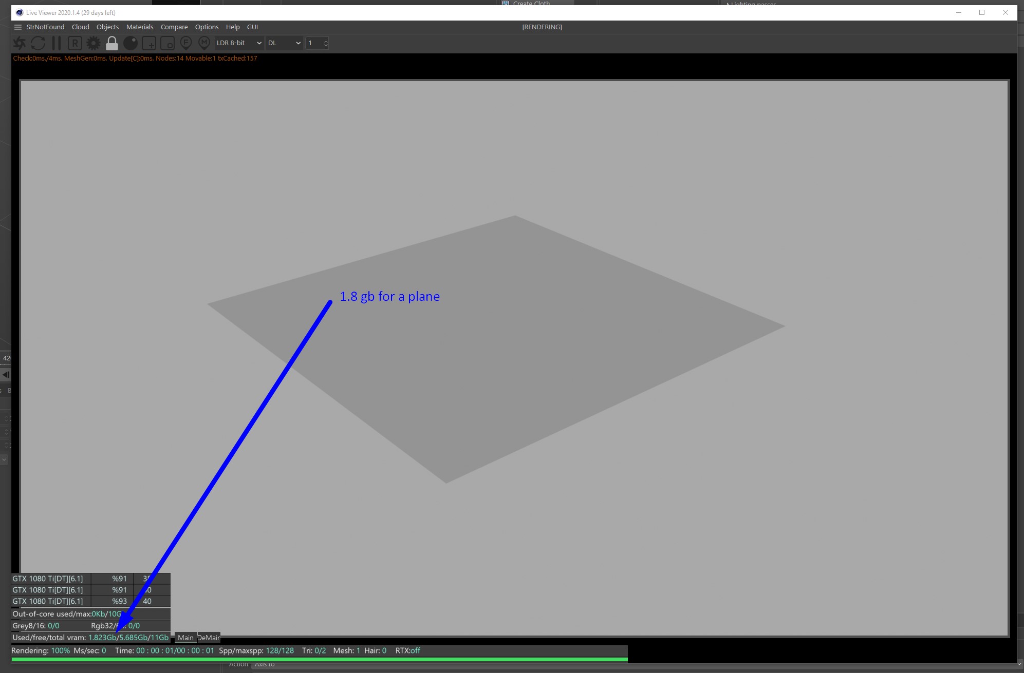

Even a simple 1 poly plane with nothing else in the scene is coming in at 1.8GB. I know this is probably a naive test but once you start adding things to the scene there seems to be an exponential scale in VRAM use.
