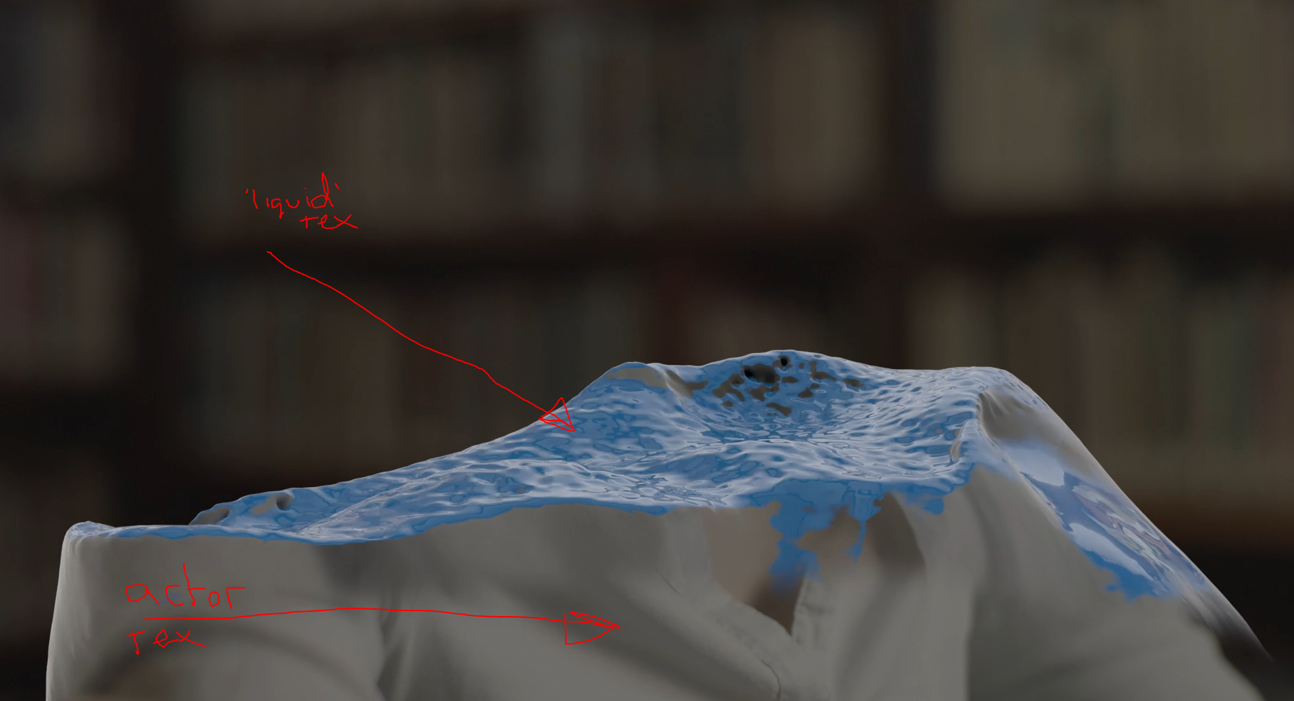

Hi Beppe, Here is about as far as I got, the basic animated mesh has a material with triplanar mapping, y+- has a blue colour, this is the 'surface'.
As you can see, I obviously run into issues with it, as the mapping projects incorrectly (actually correctly, it's doing its job, just not what I want!)
Perhaps there's a way for me to specify that a map is created where the sim contacts the cage and feed that into the texturing process?! Again perhaps less an Octane question, I am terribly sorry.

Posts: 10598
is it not possible to use a vertex map to control the transition between the actor and the liquid?

That's what I'm hoping, I'm not sure how to generate it as yet. I did try Xparticles vertex map tool but it was far too low res. Also, I'm using Octane V4 and the vertex maps can be a bit crashy, but It will still be my prefered method.
