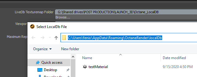

So I set that in my preferences. But it still brings me to a local folder. See screenshot for details. The only reason the orbx material is in that local folder is I copy and pasted it from that shared location, then it worked. But I want the command to bring me right to that location set in my preferences.

I'm sorry, I don't understand what question you are asking.
The preferences set the folder location where LiveDb texturemaps are stored.
The octane.importLocalDb imports from the LocalDb folder into the Modo scene, and extracts any files from the LocalDb ORBX file into the LiveDb texturemaps folder.

Hey Paul,
Oh I see, it COPIES it to that location that is set. But every time I want to import from a saved location I have to Navigate to the db we have created that is shared.
Makes sense.
So then if we want to edit an image map or something in that imported orbx file from the DB. We have to go to the assets location that was copied and not the original image location correct?

Correct.So then if we want to edit an image map or something in that imported orbx file from the DB. We have to go to the assets location that was copied and not the original image location correct?
So that folder could be a network drive, and you just need to edit the file once in order for it to change on all render stations.
There is a potential workflow which you could explore which might be useful (and I only quickly tested this, so there might be some gotchya's):
- Open Octane Standalone, and open an ORBX (say for example, the Chestnut Rushmore LiveDb material. Select the node and "Copy"
- When Modo is rendering with Octane, you can add a NodeGraph node, and Edit Node. You can then Paste the node above, and it pastes the texturemap location reference from the .ORBX file
When the above is done, the Texturemap is loaded from the ORBX file, rather than a physical file on your hard disk.
