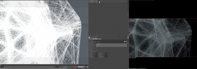

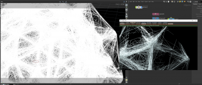

I have a spline set up, checked in Octane to render as hair, but apparently only a part of the mesh is visible in IPR.

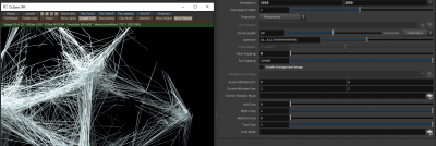

As soon as I move the near clip slider in the camera settings all the way to the up and bring back down to 0, everything works.
I have exported this as alembic in C4D and it works perfectly, so I'm guessing what could cause this issue in Houdini.
Please see attached screenshots.

Houdini setup
Houdini setup
C4d setup
C4d setup

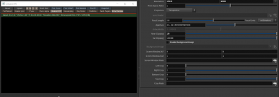

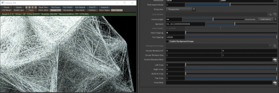

The fix for IPR live preview is attached. But that doesn't work for rendering. Might be I can keyframe it going
frame 1 = 0
frame 2 = 10
frame 3 = 0
like I manually do, but that feels like a tricky workaround.
Please see the attachments.
Turn clipping back to 0 and it solver the problem in live viewer, but doesnt solve when rendering
Turning clipping all the way to 10
