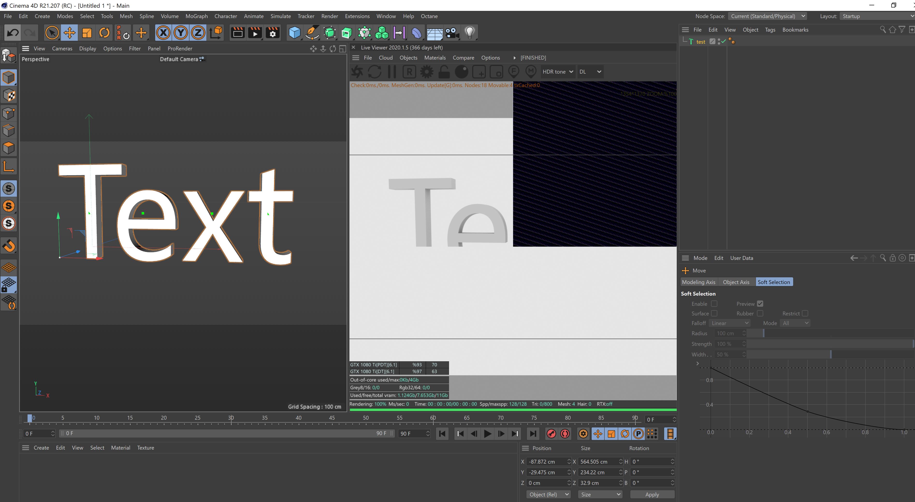

H. I open a basic scene and the live Viewer, all ok, if i move or add everything on the scene the live viewer is divided into three parts. On top left the render works, on top right is black, on lower parts
remains locked to the first frame opened. I tryed to reload, reopen, refresh, open different scenes nothing change. No issues with the standalone

the viewer with a very basic scene
Posts: 10598
it is a known issue of 2020.1.5, and it is affecting 4k monitor resolution.
As a workaround, please go to Windows control panel and set the Monitor scaling at 100%.
The devs have already identified the issue, and will be fixed in the next update.

Solved! Thank you Beppe, hope it will be fixed ASAP because it's really hard to work with windows at 100%!
