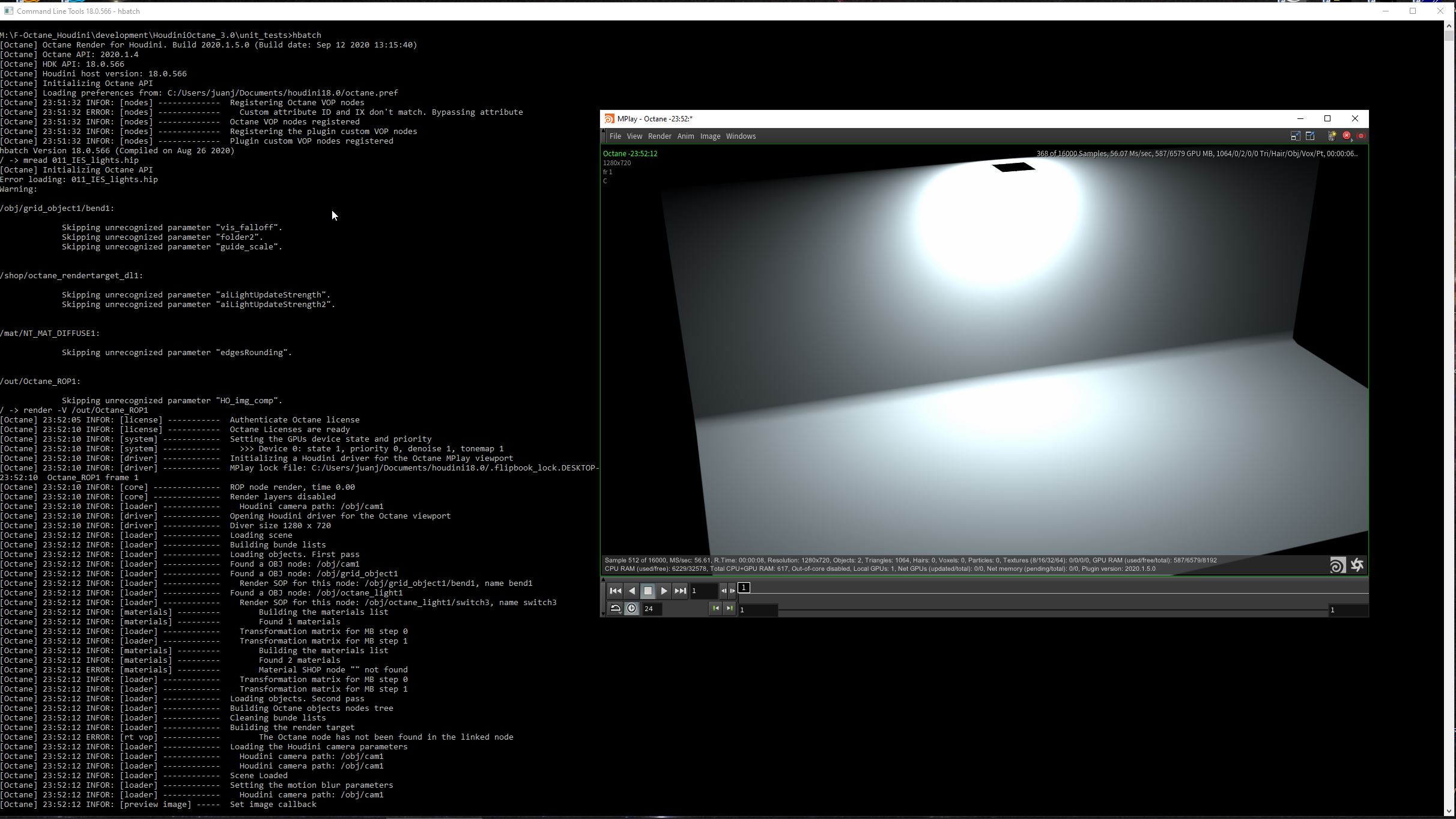

Hmm, weird. Here at least hbatch seems to work fine. I only need to execute "hbatch" from the command line tool, mread the scene file and render it, as you can see in the attached image. Do you have the same problem while doing something like that?
