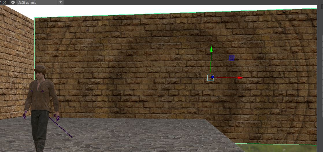

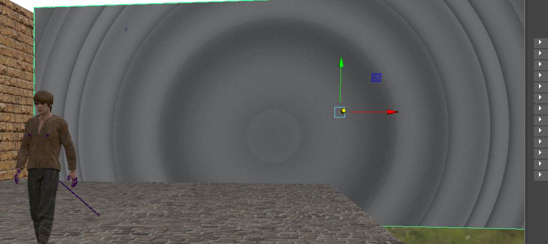

Does anyone know how to get rid of this surface pattern? Looks like a bullseye. It's on the surface before I add a texture to it.
Thanks,
Jeff
What's Causing This Surface Pattern?
Moderator: JimStar
It`s the Rayepsilon value I think, try lowering or increasing it!
