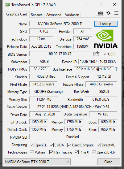

Please, download and run GPU-Z:
https://www.techpowerup.com/gpuz/
And share a screenshot from the Graphics Card tab, for all the available Nvidia GPUs, thanks:
Which exact version of Win 10 are you using?
ciao Beppe

I use Version 10.0.19041 Build 19041 (the latest one)
here you have the gpuz screen (2x2080ti)
The only thing can I say that I'm using old octane scenes (v.04), I didn't start building new ones yet.
thanks
Posts: 10643
you are using DCH version of Nvidia driver, but before switching to Standard version, do you mind to share with me a scene that is giving you CUDA error 719?
