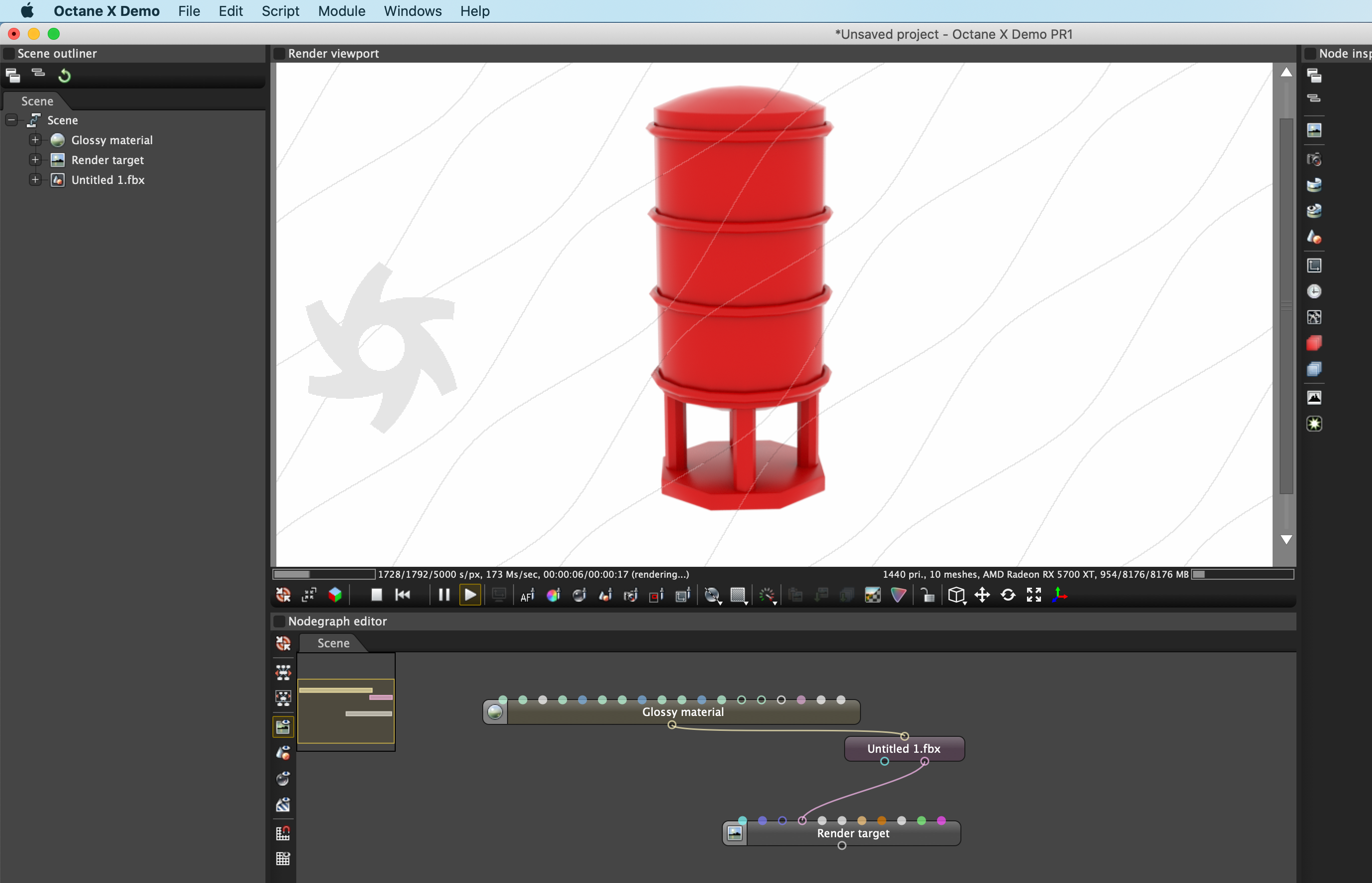

On my iMac, I am running macos Catalina 10.15.6. I downloaded the Octane demo, and it works perfectly.

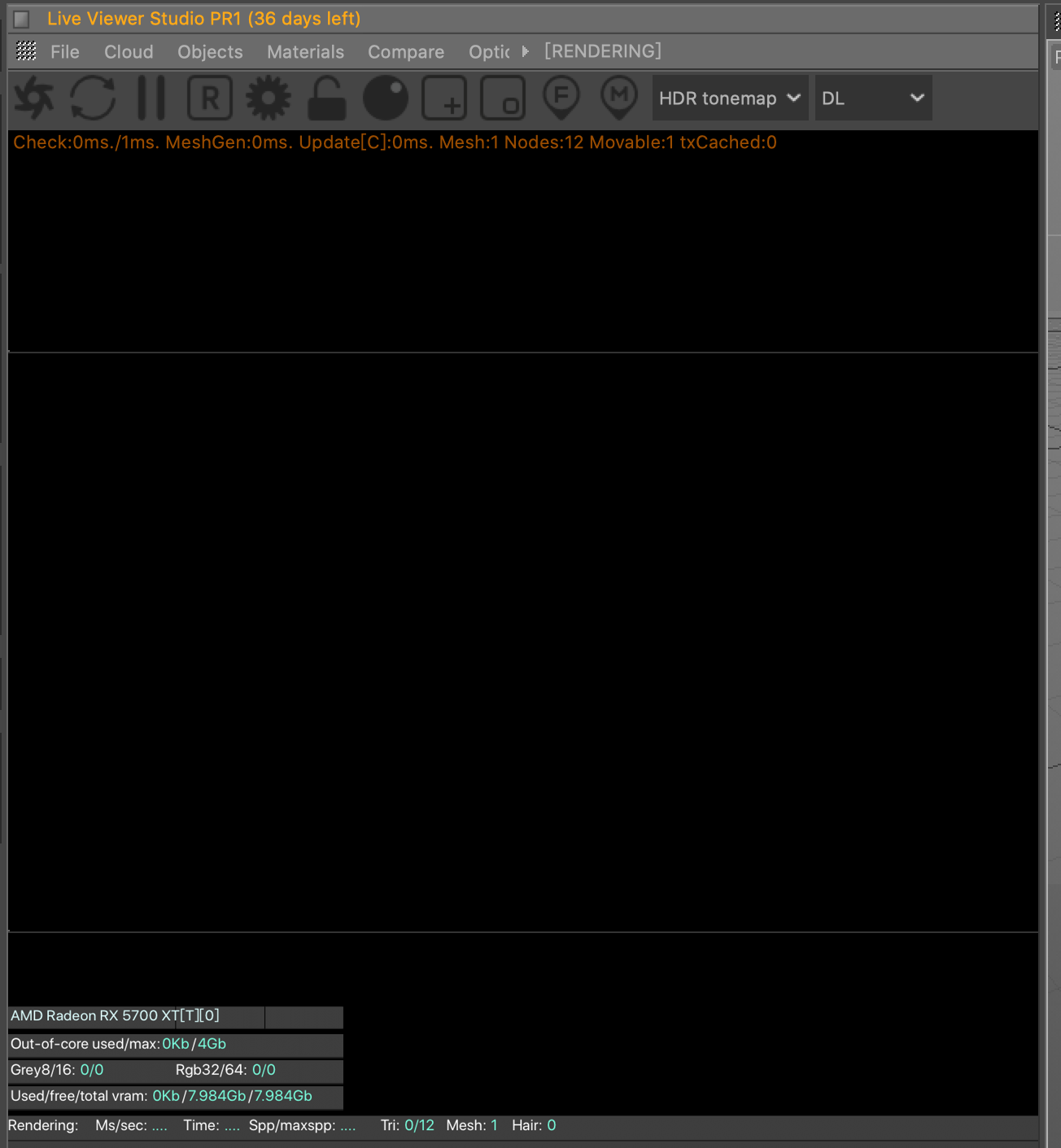

However, when I run Octane for C4D I receive the error as described here (error 2097152:113:).
My system, device and plug-in information is as follows:
GPU:Radeon RX 5700 XT
Loaded Octane DLL:Octane X Studio PR1 version:10000024 SDK:PR1
Octane X for Cinema 4D PR1 built for:200 C4D vers:20059
C4D:20059 comp:[iMac] OS:[OS X 64 BIT] OS X: Version 10.15.6 (Build 19G2021) opengl:410 sysInfo:32 versType:2
CPU:[GenuineIntel, stepping 5, model 5, instruction family 6] speed:3.7 GHz numOfCpu:20Ht
log:
Started logging on 09.09.20 12:46:42
Octane X Studio PR1 (10000024)
Compute error 2097152:113:
compute device 0: Linking 6d197dfc90d19e72 shader failed
device 0: failed to initialize render thread 0x7ff63b012730
could not pick, because we have no render threads

please note that OctaneX for C4d works only with R21 for now, the devs are working with Apple to support other c4d versions in the future updates.
