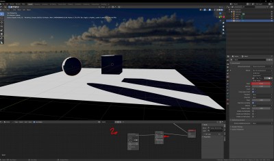

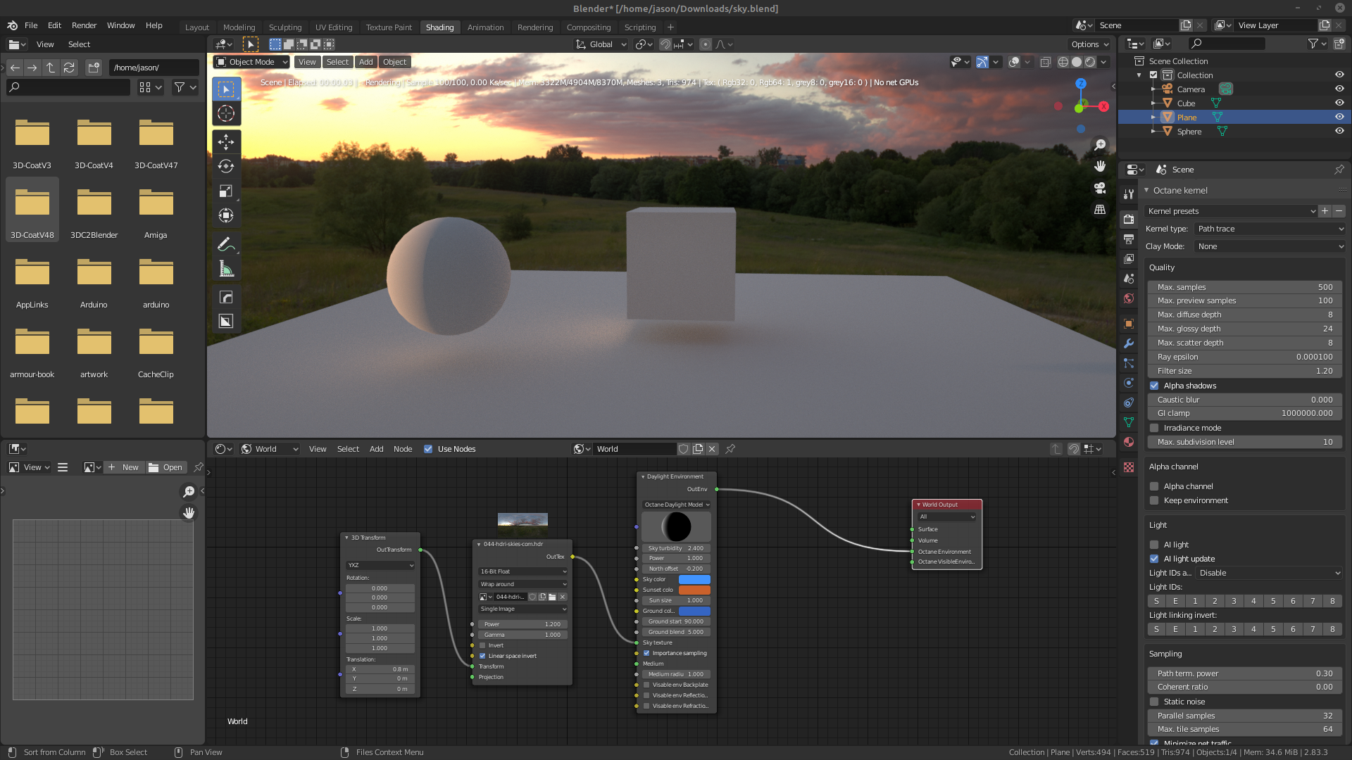

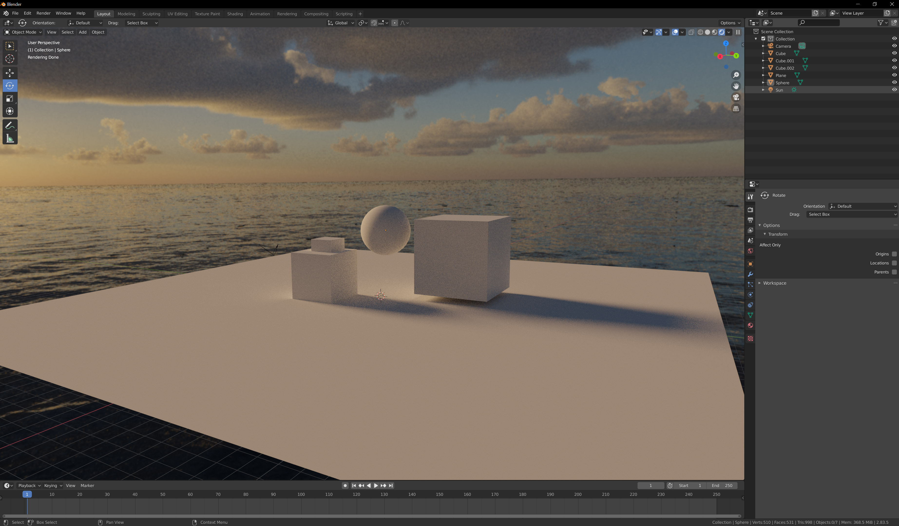

let me add to this some screenshots. i dont think this works as intended.
4 screenshots:

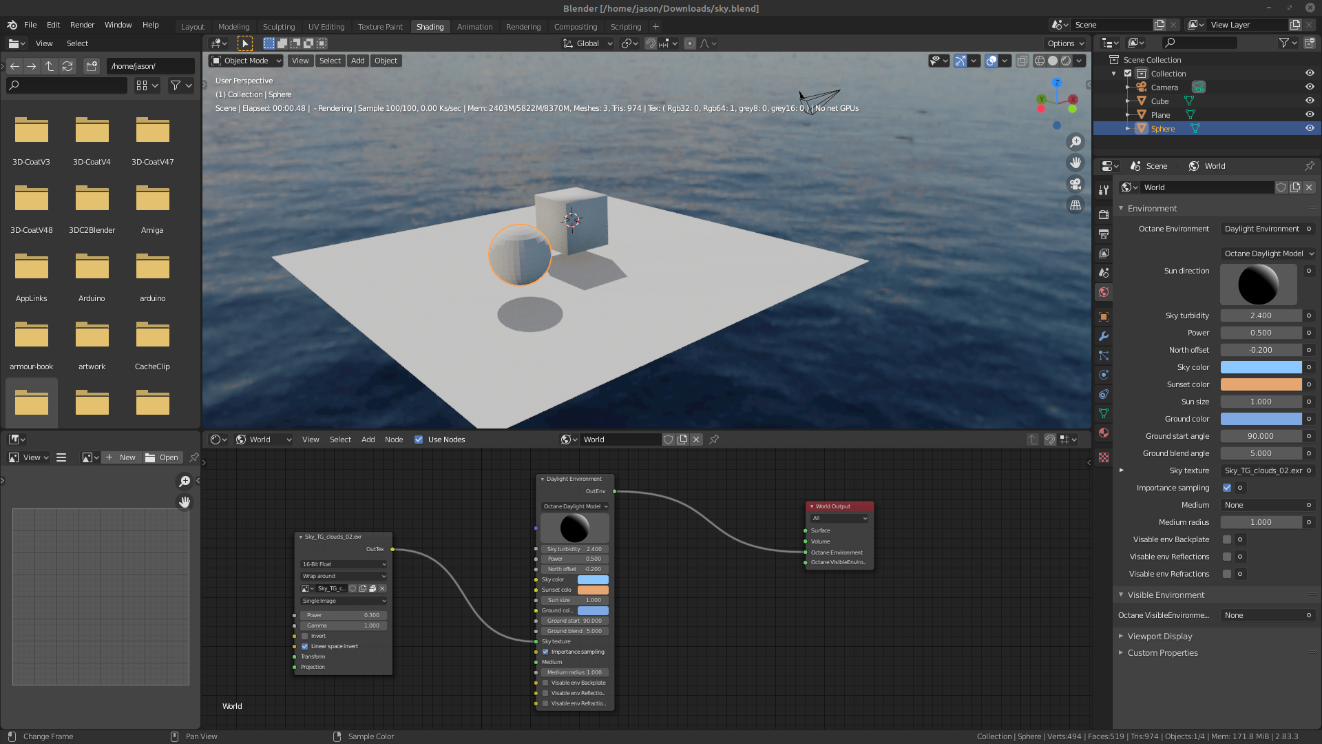

1 - i did a regular texture environment. hdr´s with brighter sun do cast harder shadows but is impossible to control.
there are two "power" values seemingly doing the same think. confusing as hell but thats beside the point.
the scene does not look bad but i need to dim the light a bit.

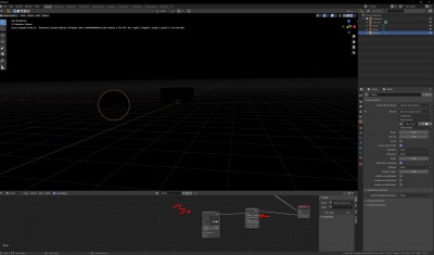

2 - i lower the light to a fraction. the ambient light is indeed very low but the direct light is still at its full intensity

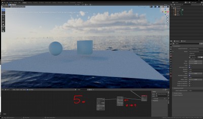

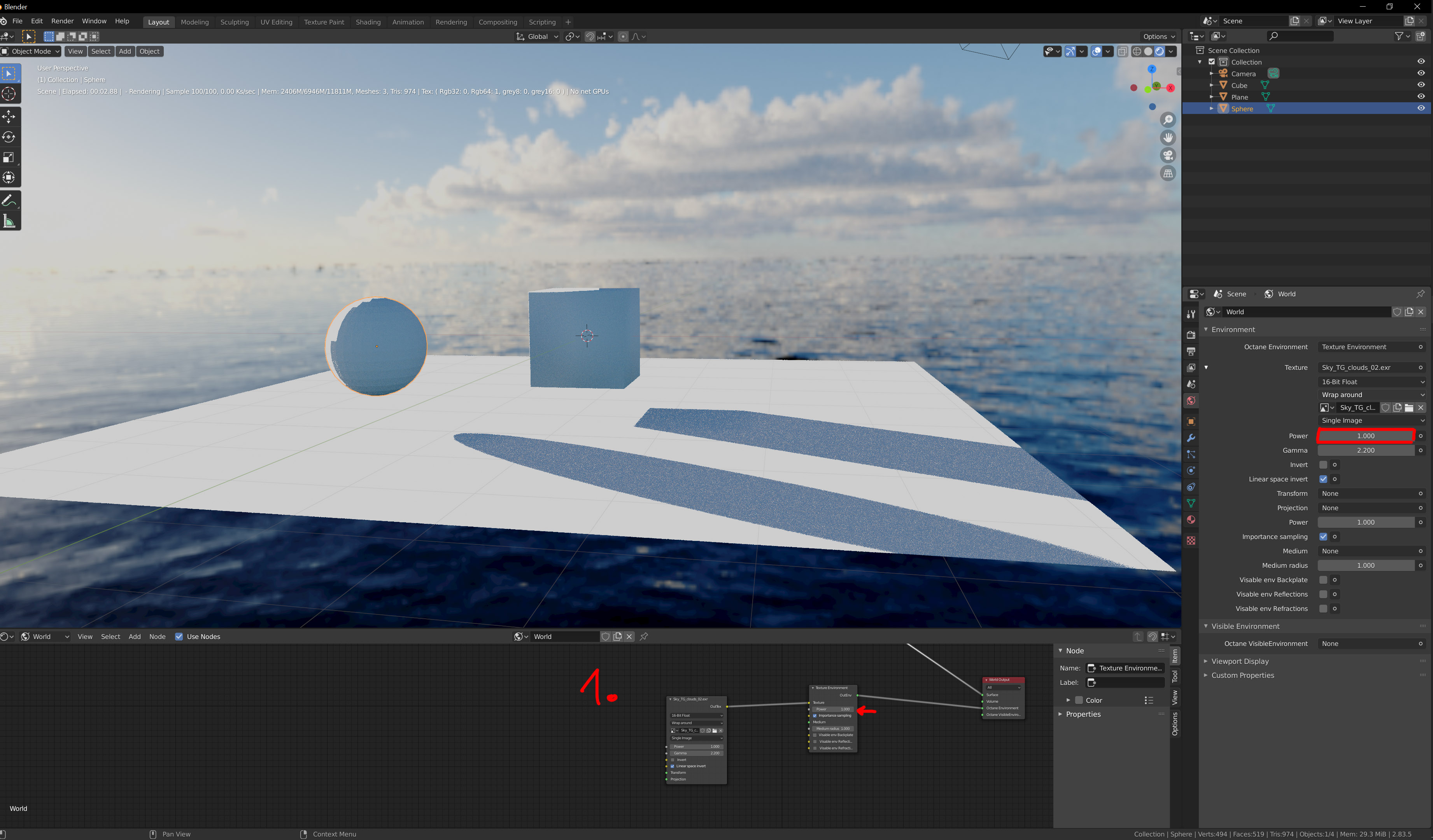

3 - i try to lower the other power (textur env) parameter to 0, basically fiddling around to see what is working. the scene as expected goes black.

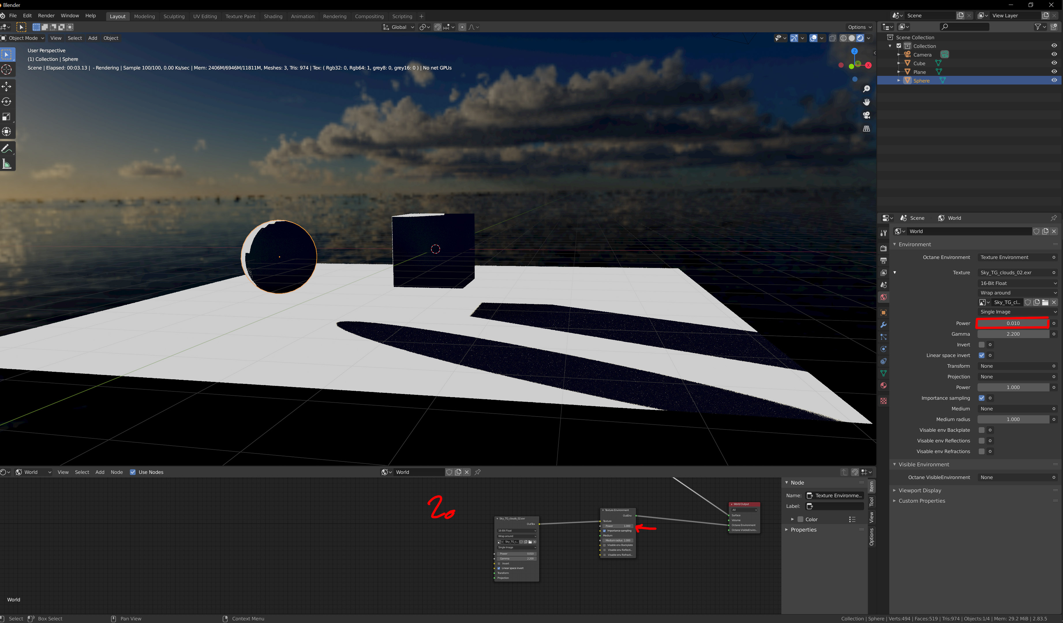

4. i bring back the same parameter, and now the lighting looks much more as something i expected in the first place, since the power level is set to 1/100.(very imperceptible ambient and direct light)

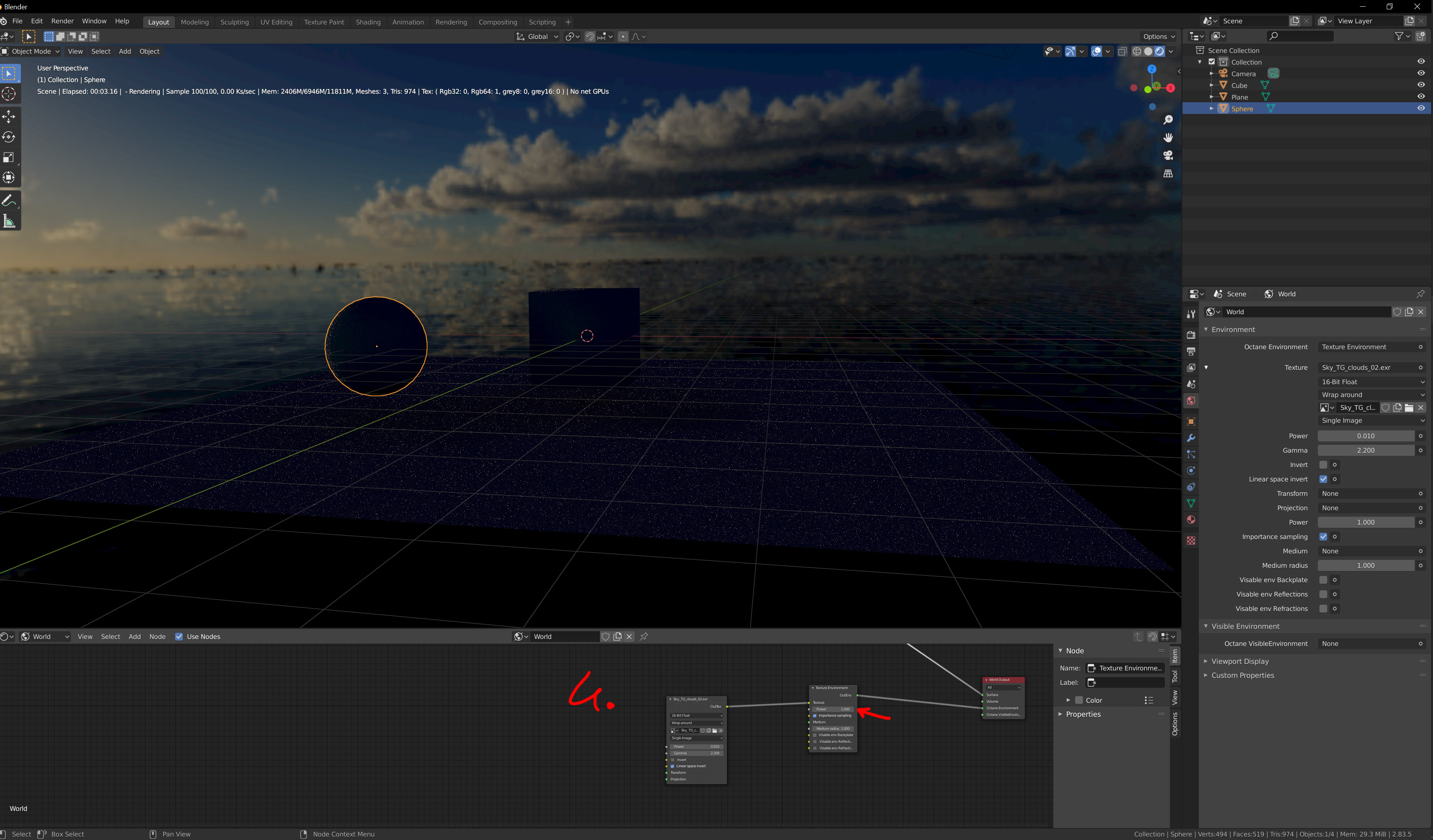

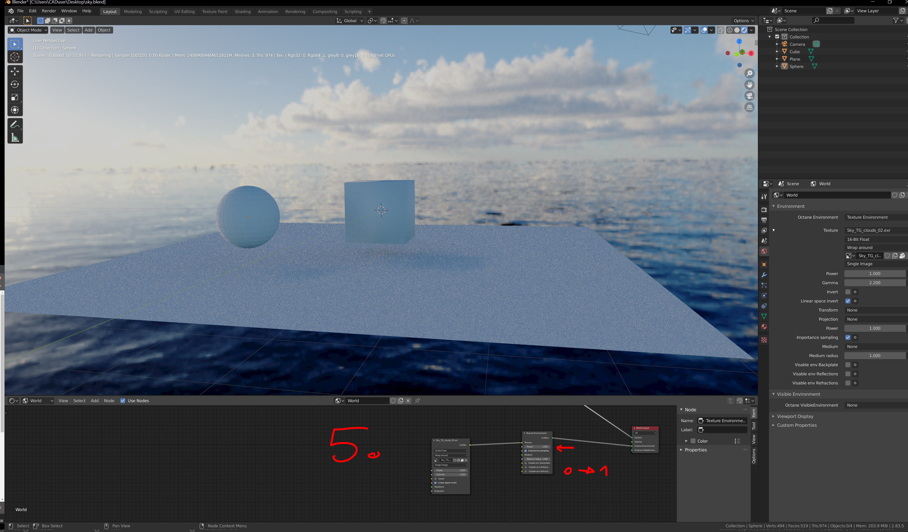

5. i reset the first value i´ve changed back to 1, and just try the same trick: setting the power of texure env node to 0 and then 1, and the result looks as if there is no direct light at all, only ambient.
the fact that changing and resetting of texture env power level can produce two completely opposite results, instead of reverting to its original look, tells me there is something very wrong here. this cant be right
i am trying to keep this short and spare you my permanent frustration with octane, especially in blender host.
here is the packed blend file fwiw. https://we.tl/t-zOKGEEFLcY

I think you have a couple of things you might want to change. First, I would start with the Daylight Environment node and then plugin your .exr into the Sky texture pin. This is how I usually mix the two together. Also your .exr is very strong, it looks better with a gamma of 1 instead of 2.2. I usually play with it because some HDR images have the gamma baked in. I also put textures on the objects in the scene, I know that Octane will default to just plain diffuse but I like to be sure. Hope this helps some,
Linux Mint 21.3 x64 | Nvidia GTX 980 4GB (displays) RTX 2070 8GB| Intel I7 5820K 3.8 Ghz | 32Gb Memory | Nvidia Driver 535.171
i appreciate your tips grimm, thanks.
that method does let me use both sun and the custom sky map.
problems remain, and its all due to gamma i think. the buggy behaviour i mentioned i believe is a different problem too. going back and forth between parameters should not be causing completely different unpredictable results.
if i understood correctly, you are saying that each hdr has a different gamma value baked in, similar to displacement map that work best with certain specific value.
i was under the impression that its either 1 or 2.2 and felt dirty when i was winging it with some random values.
after i initially posted, i managed to get some more acceptable results by putting a colour corr node after the sky texture. it seemed to clamp the overexposed parts. but back to your example:
ive set the gamma of the texture to 1.8, seems to be a nice enough balance of contrast and intensity.(1 ist too washed out. i still want to have more dramatic darker clouds)
however, there is still a huge difference between the sky and the actual sun.
i would expect to modify the sky map and sun independently but power actually changes both.
it seems the sun is too bright in the texturemap for some reason, so maybe the values in the hdr are off too. octane has no curve correction, i will try and trim it down in photoshop.

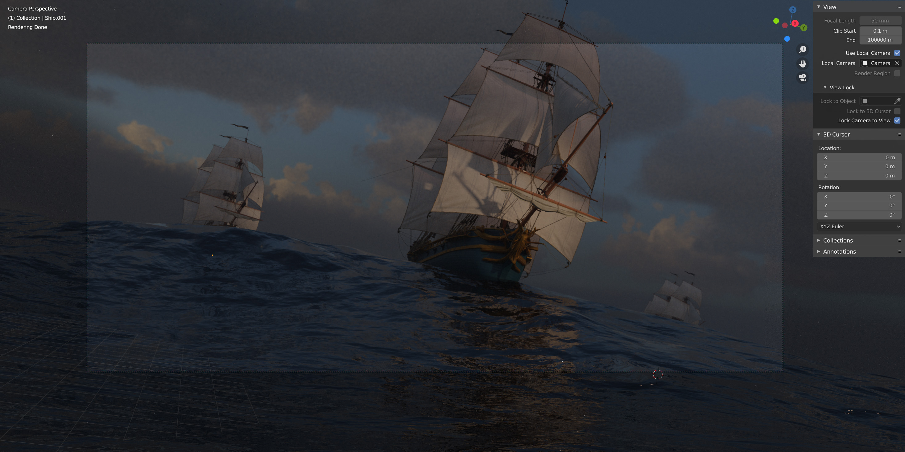

like i wrote earlier - with cycles i managed to get the look i wanted with ease. attached is a screenshot. the funny thing is, i have been using octane far longer than cycles.

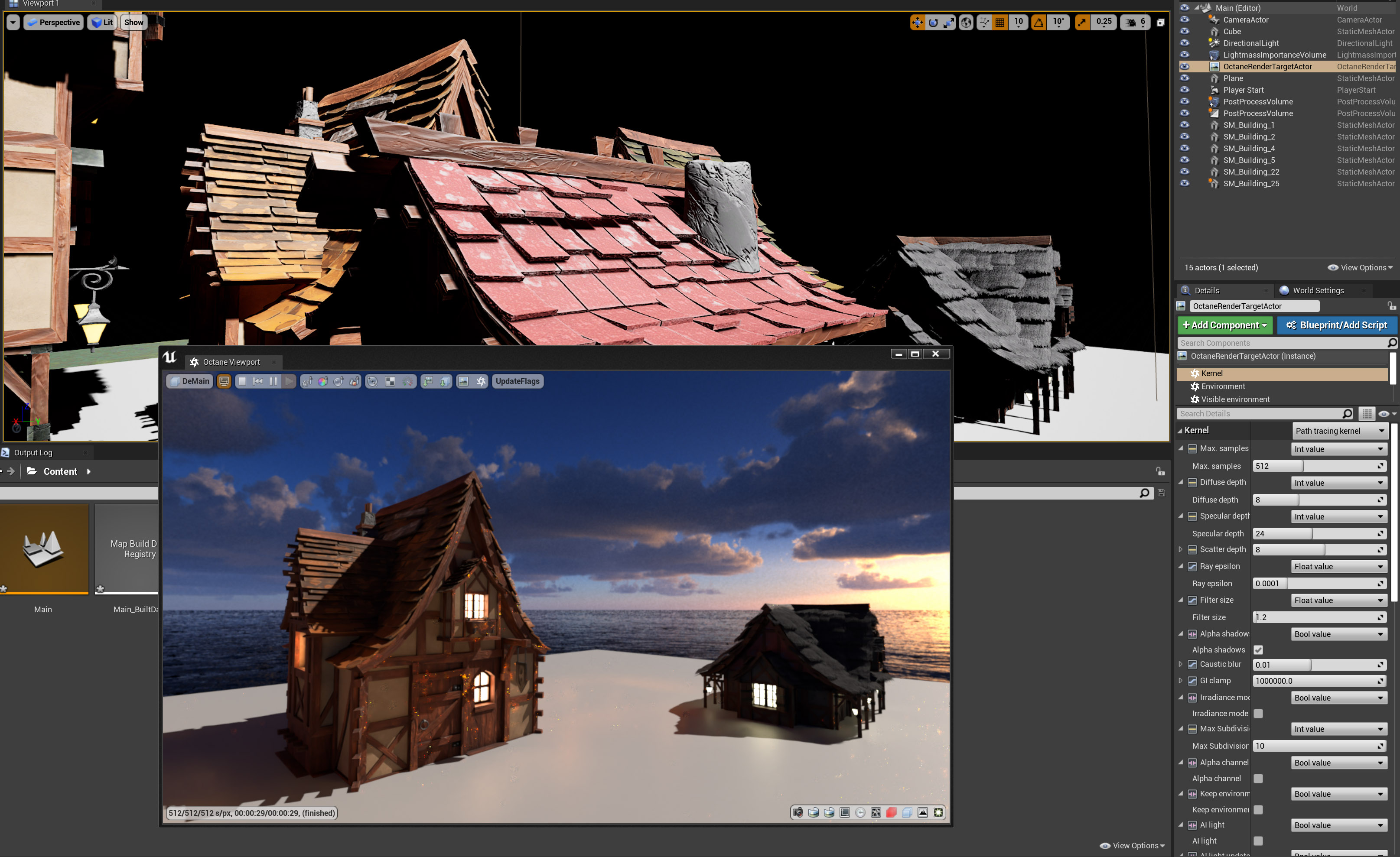

a quick post scriptum, i just tried to import the same image into unreal engine octane and it works perfectly. i dropped the texture into the env slot and had a distant light act as sun.
no issues whatsoever. i can even modify the sun and enviroment light independently and setting it up took 30 seconds:
- the distant light intensity modifies the env map strenght
- the sun intensity modifies the direct light strenght
btw - unreal engine plugin, even in its early stage, has the native material and light support. i can even get a spotlight going if i want to.
creating and finetuning fog is a breeze too, nothing like the issues in blender.
i dont want to come off insulting but blender plugin is nowhere near usable. maybe its the underlying blender code that is causing troubles, but again e-cycles works like a charm.

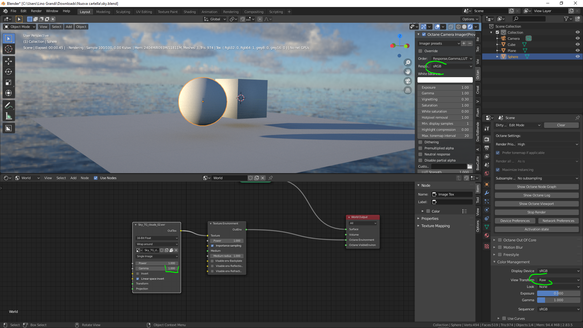

You can use the Use Curves option in Color Management.crackfox wrote: octane has no curve correction, i will try and trim it down in photoshop.
cheers,
Are your Color Correction options set as needed, by the way?
* Display Device: sRGB
* View Transform: RAW
* Look: None
* Exposure: 0.0
* Gamma: 1.0
- linograndiotoy
- Posts: 1538
- Joined: Thu Feb 01, 2018 7:10 pm
I just checked your file.
As i suspected, your color correction settings are incorrect (the color correction was basically applied twice).
You should use Octane's color correction option, which translates in settings View Transform to Raw.
Normally the gamma for HDRI should be set to 1, but of course it's possible to tweak the value a little bit to get the wanted lighting.
I hope this helps.
I hope this helps.
