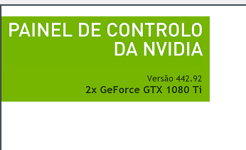

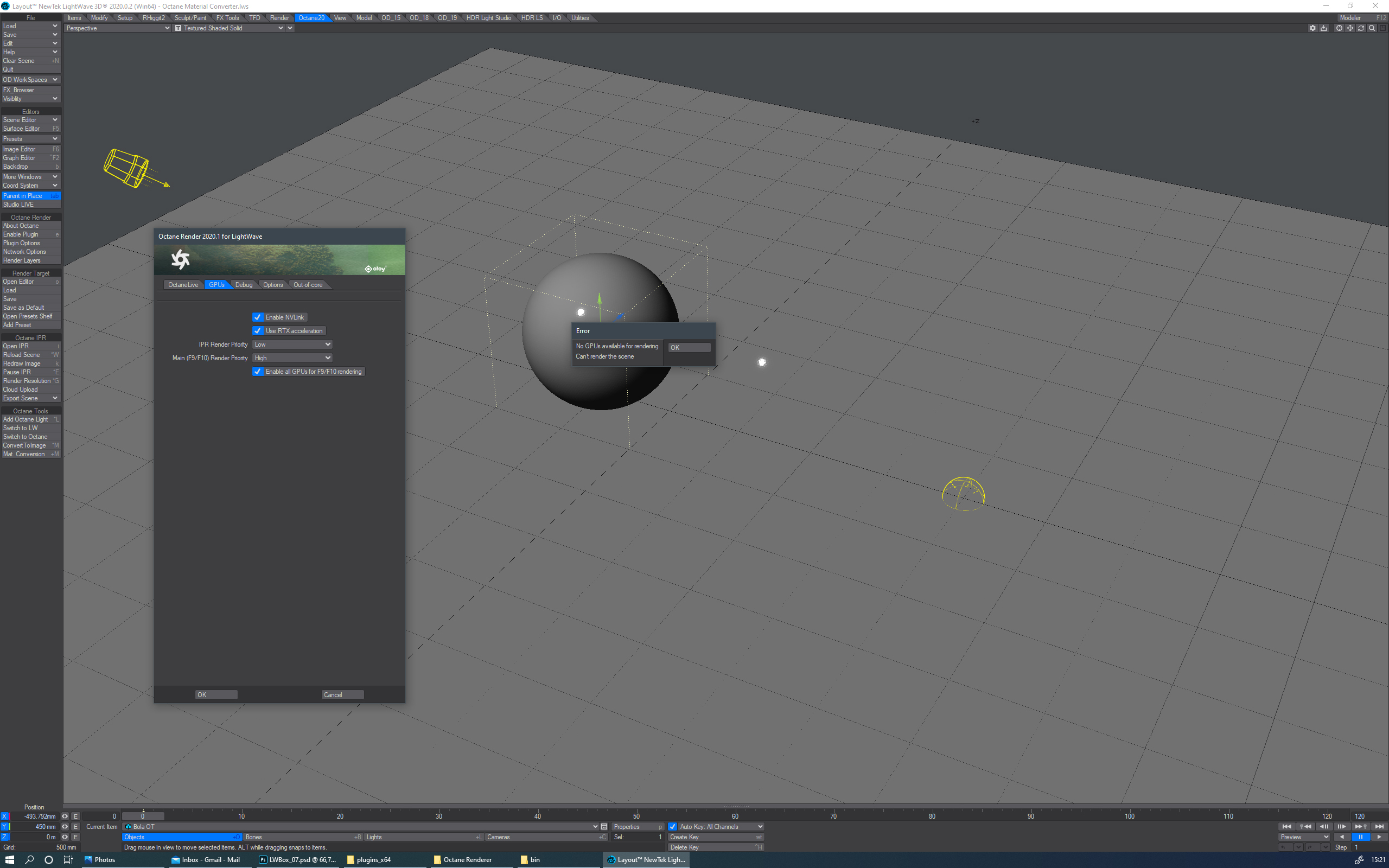

I installed the latest version of the octane (2020.1.5.0) and my cards simply stopped working
When I turn on the IPR or F9 I get the message saying that it is not possible because there are no GPUs to render.
I have drivers above recommended (V442.92)
Or am I doing something wrong.
Thank you.

Make sure to use a NVIDIA Studio driver with version at least 451 on Windows. I'll update this information in the post.
