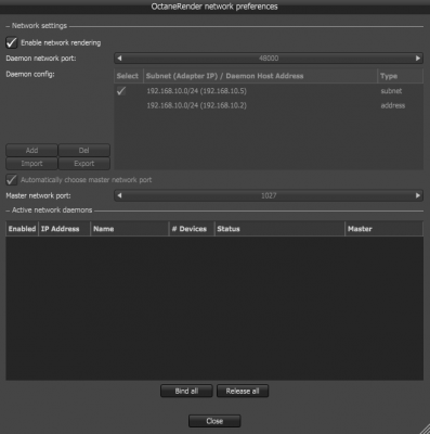

Hello,
I run c4d Plugin 2020.1.4 and now 2020.1.5 in my PC windows 10 and don't see my Mac slave.
I have 3 mac slave (cuda), 1 Mac (metal) and 1pc (windows 10) in the same network.
in the Mac (metal), I see 3 Mac, but not my pc…
is there something to do on windows so that it can see the others?
I don't know where to look :(
my windows version is : 1909
firewall and network protection is disabled
Thanks for your help

please, make sure to have enabled the Private Connections in Windows Firewall, for both Standalone and C4D in the Warkstation, and Standalone and daemon in the Render-Node:
Also antivirus and internet softwares can give issues with daemon connection, try to disable them if Firewall is not enough.

Hi Bepeg4d,
thank you very much, you have found exactly what i was looking for. I also uninstalled the anti-virus which was also the cause.
it's now gone with my slaves :)
