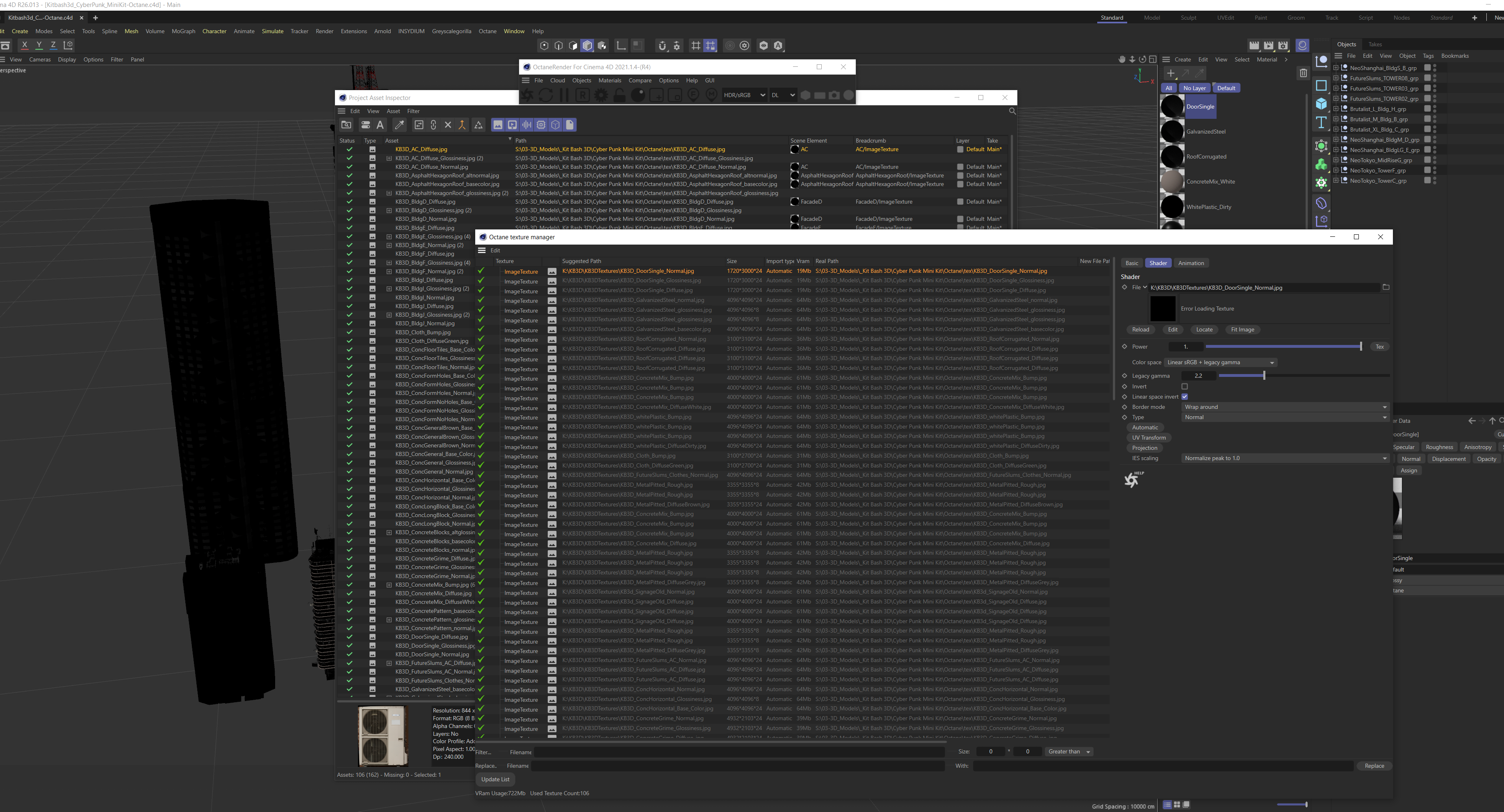

Im getting the same issue and tried what you say above but still no joy.jayroth2020 wrote:Use Globalized filenames, as these will be an absolute reference to your texture. You can select the textures via Window > Project Asset Inspector and then choose Asset > Globalize Filenames from the menu. Then, go to Octane Dialog > Materials > Octane Texture Manager and refresh the file list.
The Real Path in the octane texture manager is correct but the suggested path still stays with the old reference.
As you can see, there is still an error loading texture. See picture.
Am I missing some step to fix this?
Any help appreciated. Many thanks.
