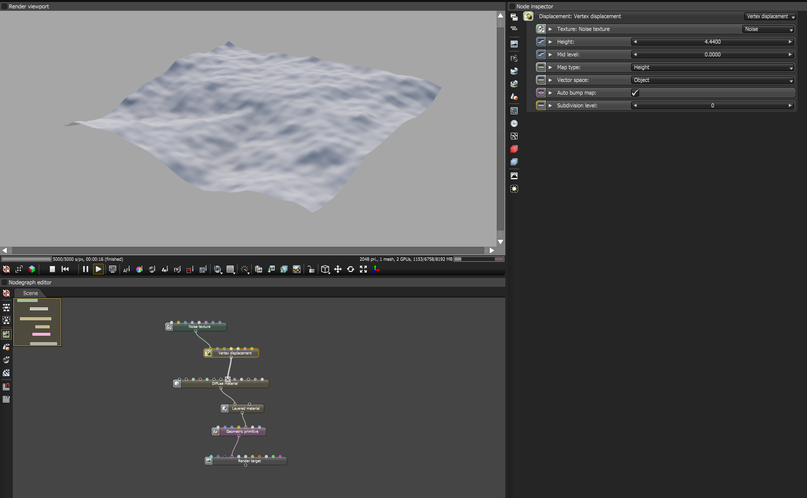

There is no input for displacement in layered material.

We can plug it in the material mixer node and plug displacement into mixer node and set it to 100%.
I don't get this. You are supposed to have a base material in Layered Material and plug displacement map there. No need to use Material Mixer

It doesn't work that way, same with material mixer, Octane can only use displacement plugged in material mixer not the ones plugged into the mixer, but the way I described in previous post works.
