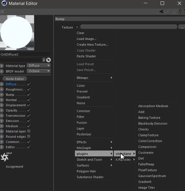

How can I go about getting Octane out of this "plugins" submenu and put it above of where "Effects" is? That's where it used to sit in previous versions of C4D, now it's moved. I tried looking around in customize menus but I couldn't figure out how to move it. Any help would be greatly appreciated! :)
Attached is a picture to show what I'm talking about.

Have you installed the plugin in the following path?
- C:\programs\Maxon\Cinema 4D R20\plugins\c4doctane
If yes, try to move it in the following path:
- C:\Users_Your Name_\AppData\Roaming\MAXON\Cinema 4D R20_random code\plugins\c4doctane
ciao Beppe

Hello! I tried that, but faced the same issue. I then tried removing X-Particles, that worked and return Octane to it's normal position. So I guess it groups them into a folder if it's multiple plugins. I need to find a way to break them off into separate categories. I have my muscle memory so dialed in for Octane being in that position, I refuse to change it hahaha!
