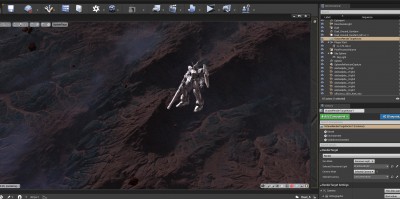

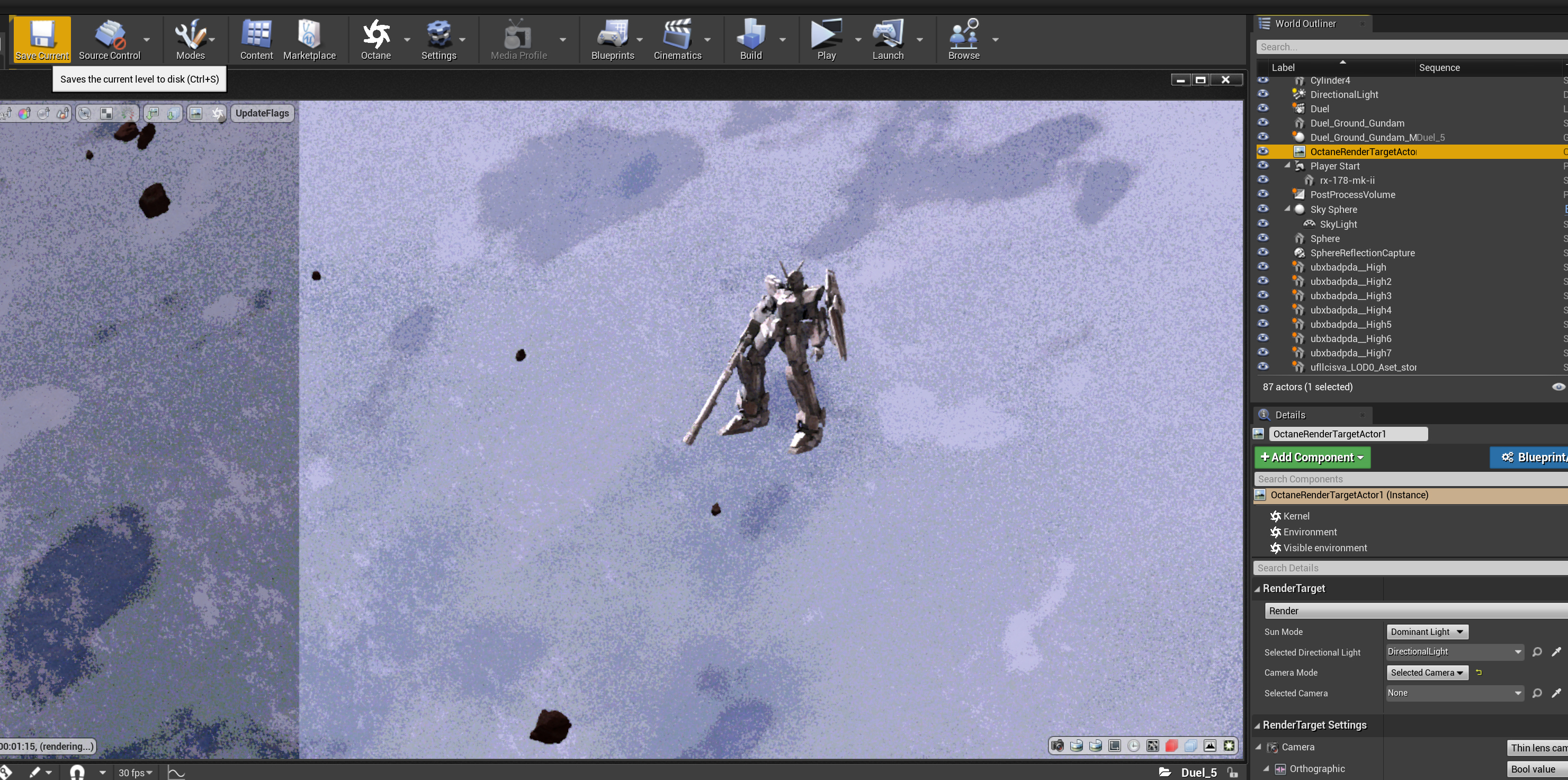

i have uploaded two screenshots:
the first one is the scene properly set up.
the second is while pressing the save button. you can even notice the button still being highlighted.
the camera target revert to none, and also you can notice the background blinking out because of the standalone bug.
