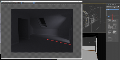

I was testing around and i found two strange things;
1 - This Vectron geo, emits light in a strange direction, although the Octane Light stat parallels the window and even though the light is off, it still illuminates the scene.

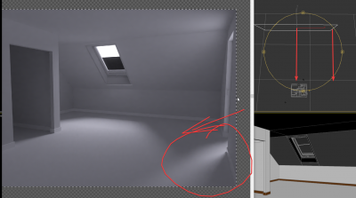

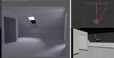

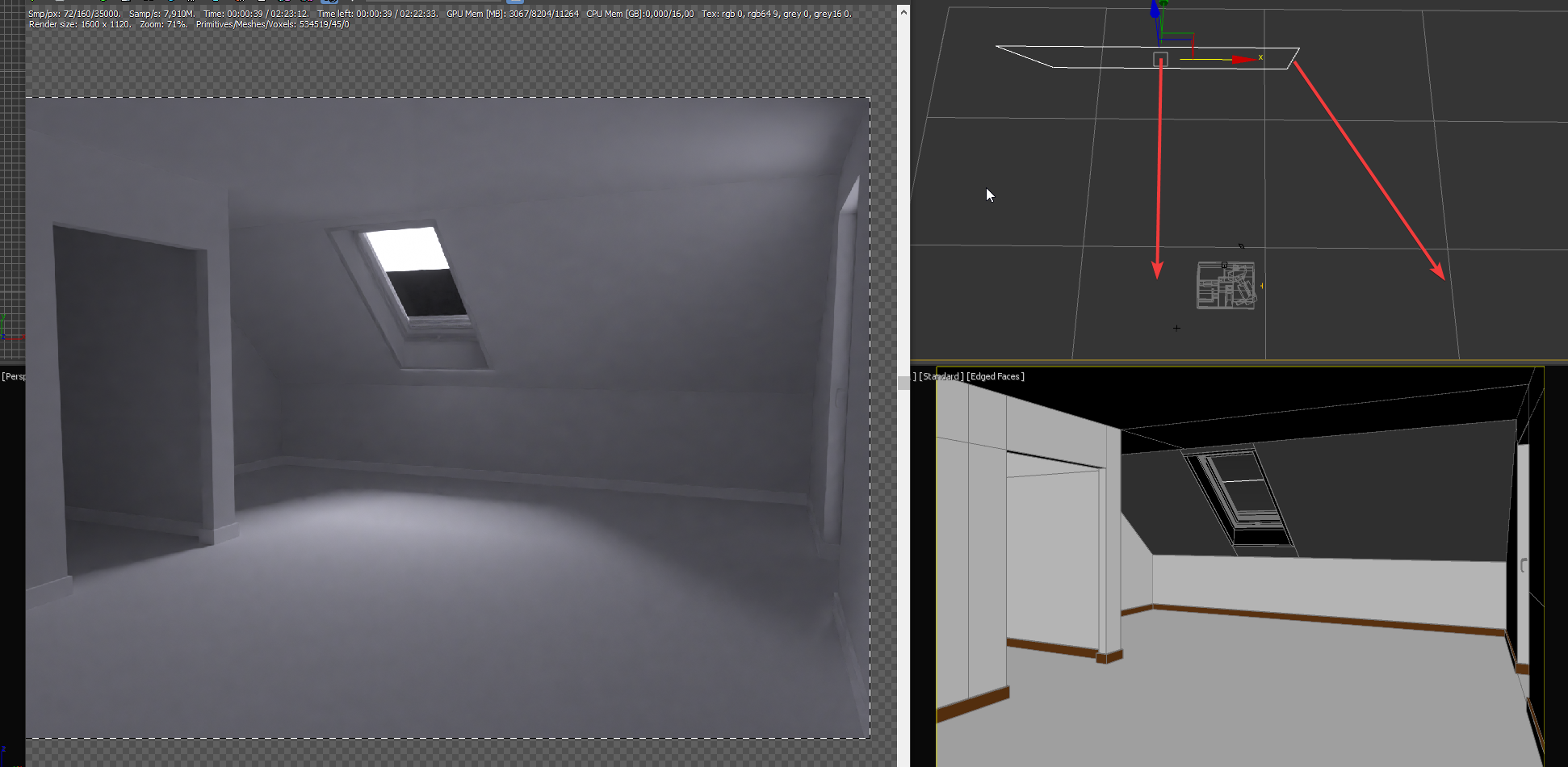

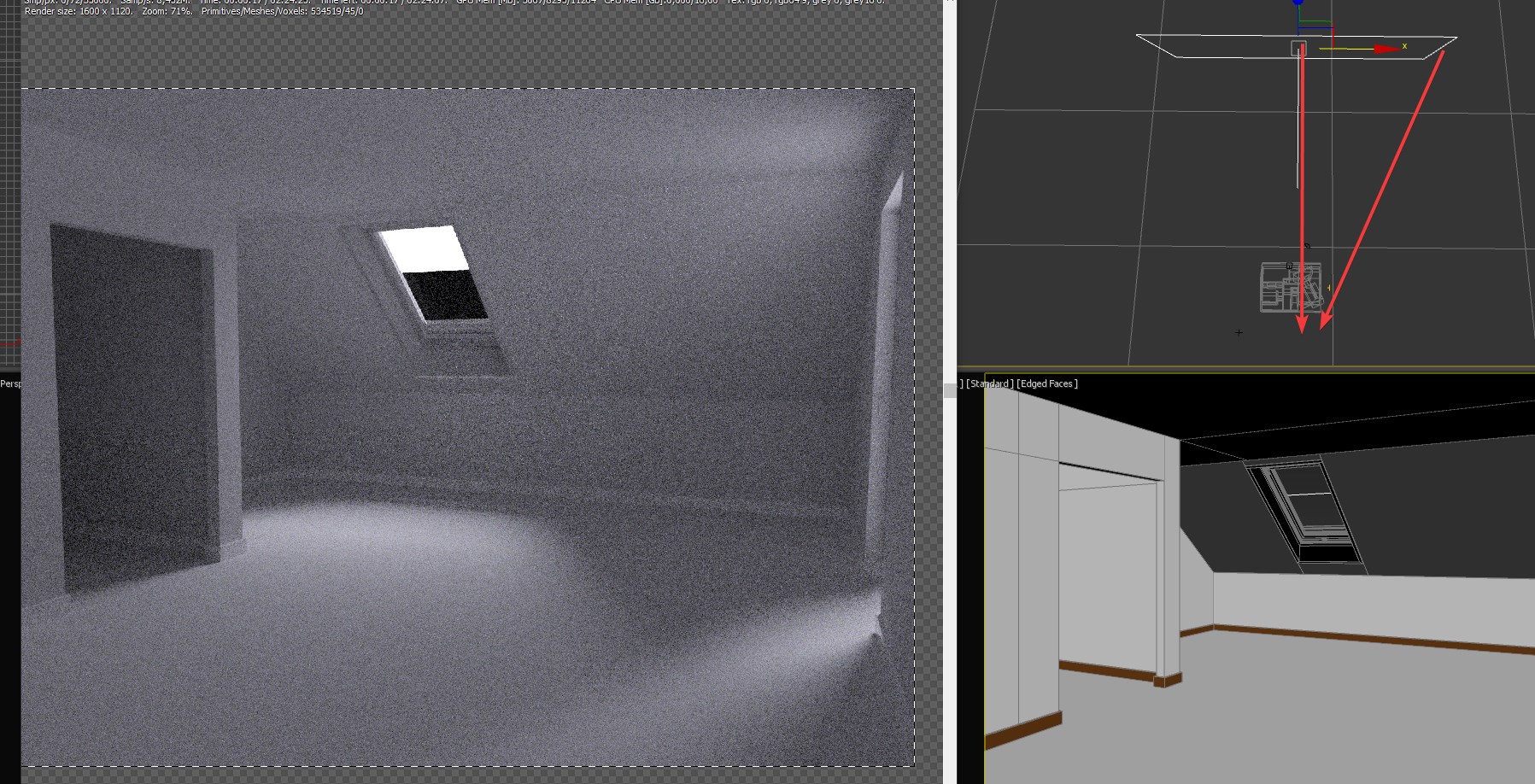

2 - What's the pattern of light distribution? It seems very strange to me
a
b
c
3 -

I'm not sure about the first image, but image A, B, and C looks correct. Big Area lights have a wide light distribution and doesn't just travel straight. If you use a distant light, you'll get more parallel results.
