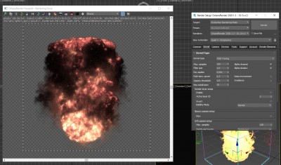

I created a fire animation using Phoenix FD in 3ds max 2018. On a black background it turns out like this:
If you change the background to white:
Then practically nothing will be visible.
Result:
There was a problem with opacity. How to solve it?

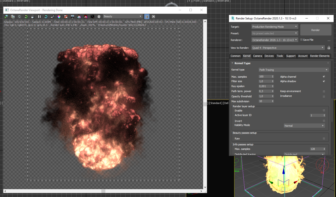

In this project, the results are as follows:
How to achieve the same result in my project?

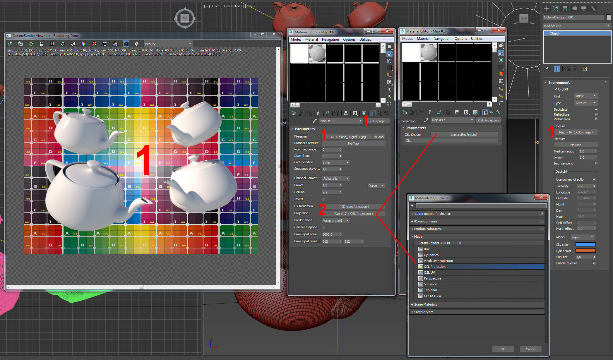

paride4331
Posts: 4004
Hi Cobaltium,
using 3dSMax environment you will illuminate your scene, it is not a backgroud.
try using 3dSmax background: 3dsMax > view > viewport background
or octane OSL environment.
Regards
Paride
osl-env2.zip
(1.32 MiB) Downloaded 237 times
01.zip
(5.15 MiB) Downloaded 218 times
