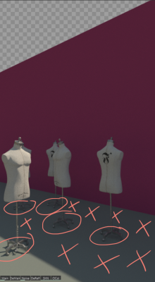

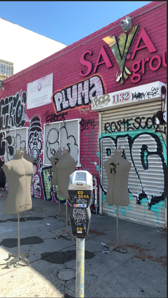

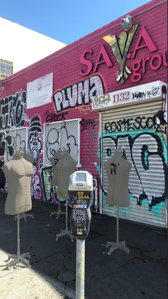

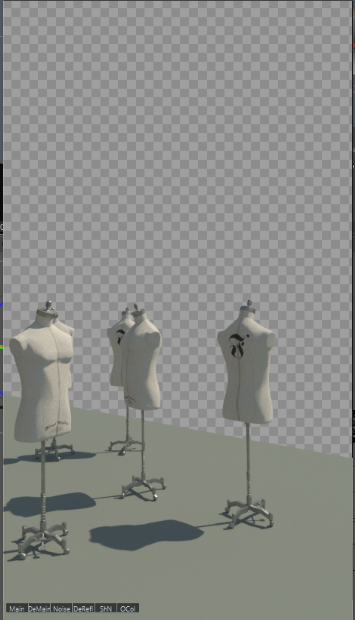

Here are some screenshots - I want to keep the shadow style they cast on the floor but not keep the whole shadow the wall casts, if i keep it too then it doubles with the shadow already existing in the footage and it becomes too dark.
Here's how the render looks when i remove the wall:
And this is how it looks when I composite the shadow without the wall - it's too hard and doesnt blend realistically with the shadow on the floor:
Here's what happens when I keep both shadows in the render, the floor shadow gets too dark:
