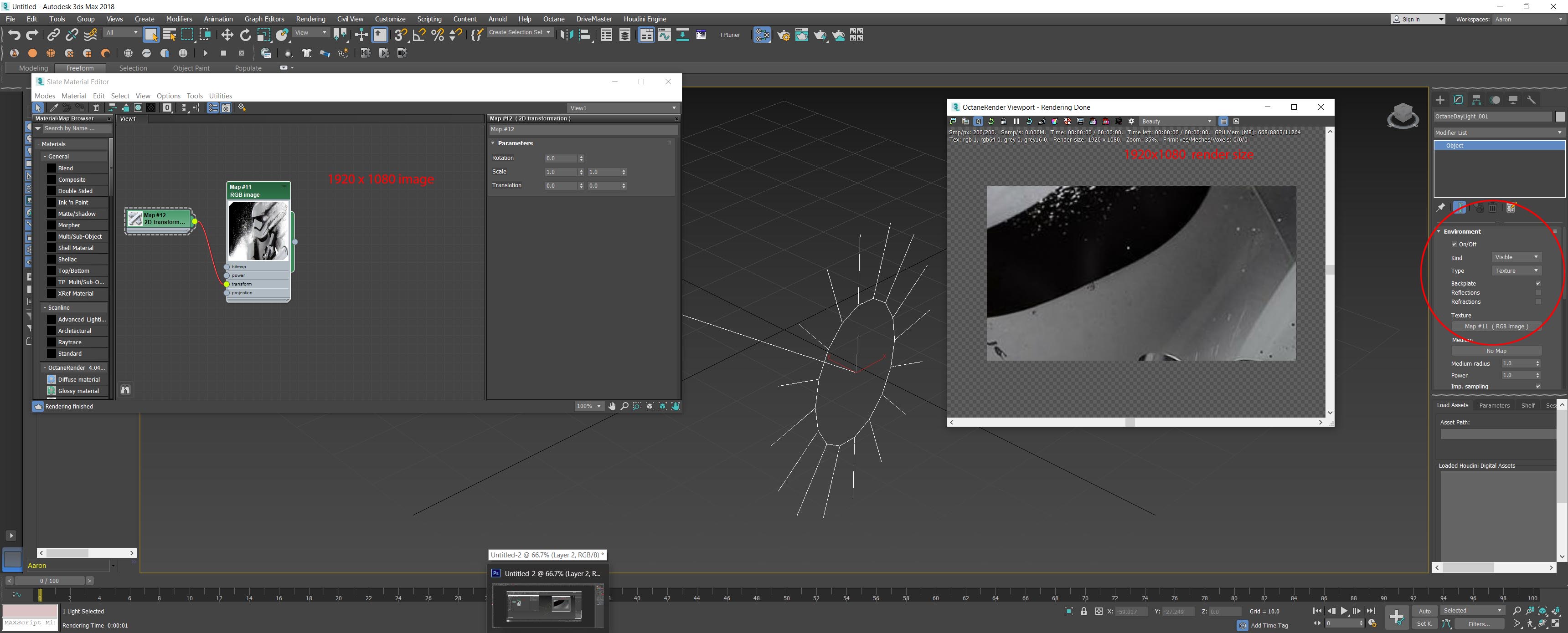

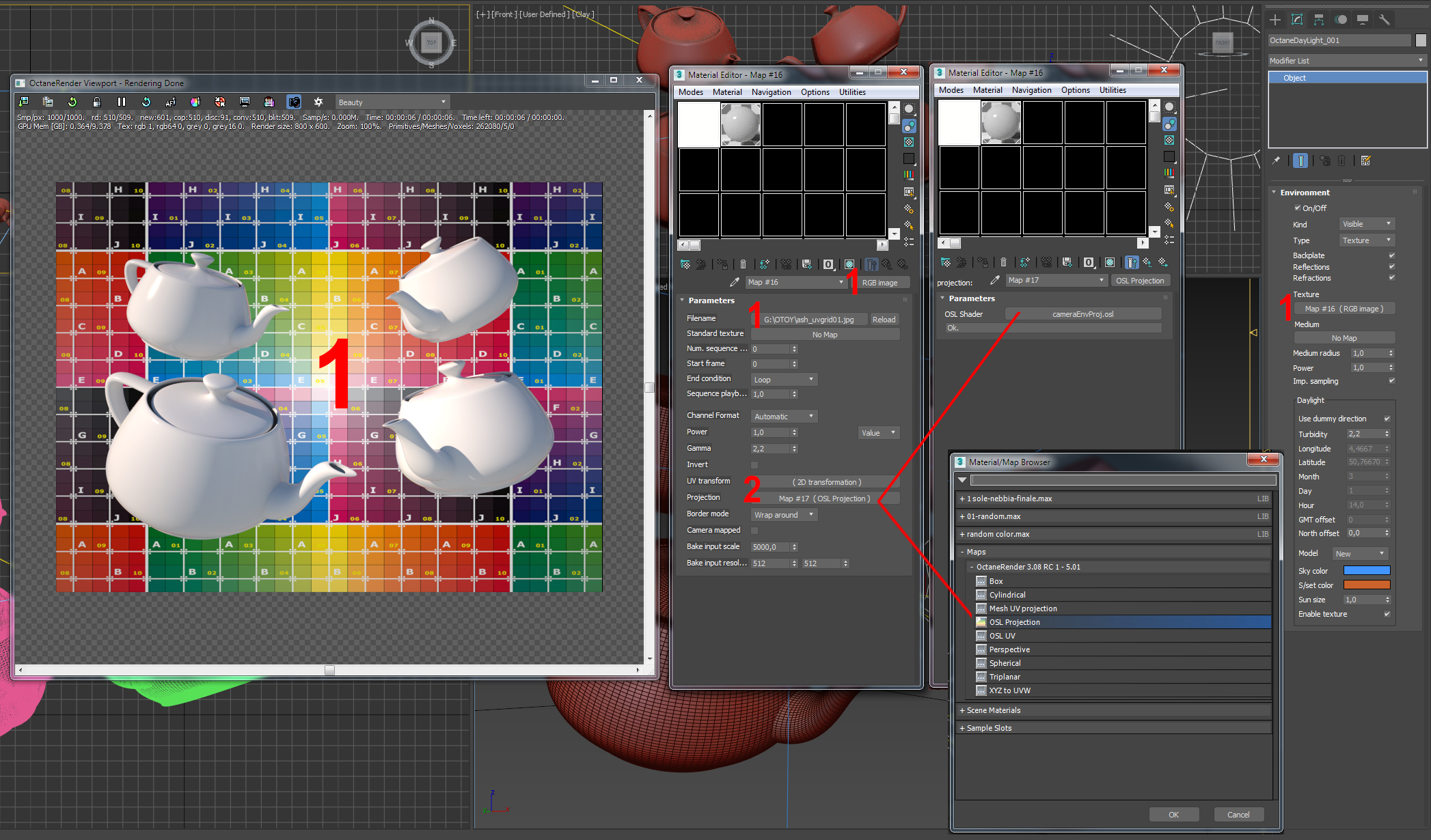

Hiajoshua4,
you can use the OSL environment.
Regards
Paride
