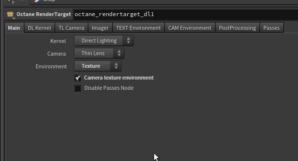

Hi, in the C4D plugin I can set up a primary environment to light the scene and a visual environment that renders instead without lighting the scene. How can I set up something similar in the Houdini plugin?
Thanks in advance.

Enable the "Camera texture environment" option in the render target HDA.

Thanks a lot juanjgon
