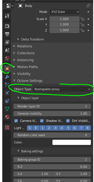

As I suspected, you just need to change the Object ype to Reshapable for all deforming meshes:

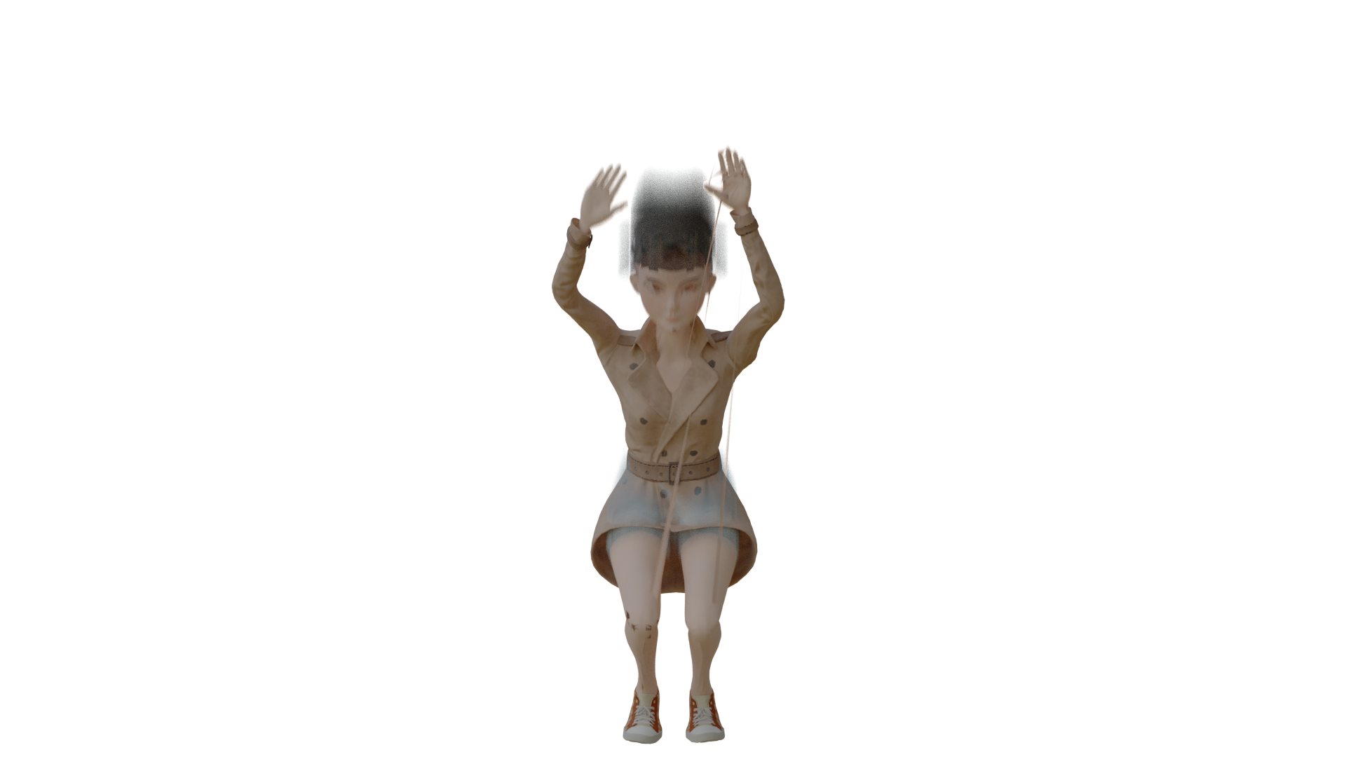

I've tried giving all the geometry with vertex groups a deformation value of 8 as they don't seem to get blurred with lower numbers .. but I'm getting this weird artifacting (see pic).
Also, I've put all geometry to Reshapable Proxies.
My big question is .. why does the hat and glasses etc (no vertex groups) come out ok and the other geo (with vertex groups) is different and difficult to manage? Can I set up an easy way of dealing with this? I have another 10-11 characters I'll need to fit into a scene.

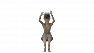

Yes, that's something I noticed.cheeseburger wrote:P.S. If I put a subdivion surface modifier on the face and body, the motion blur completely disappears ..
I've found 2 possible workarounds for it.
First, try to select the meshes and make them "Smooth".
If this doesn't solve the issue select the mesh just add a Vertex Weight Edit Modifier just after the Subdivision Modifier.
You should see Motion Blur working fine now.
- cheeseburger
- Posts: 61
- Joined: Wed Apr 21, 2010 10:26 am
Yey !! I tried Smoothing faces, edges, vertices and normal vectors and that combination worked ! Now I just gotta write me a script to do this automatically. A good excuse to buckle down with Python Fantastic .. Thanks
