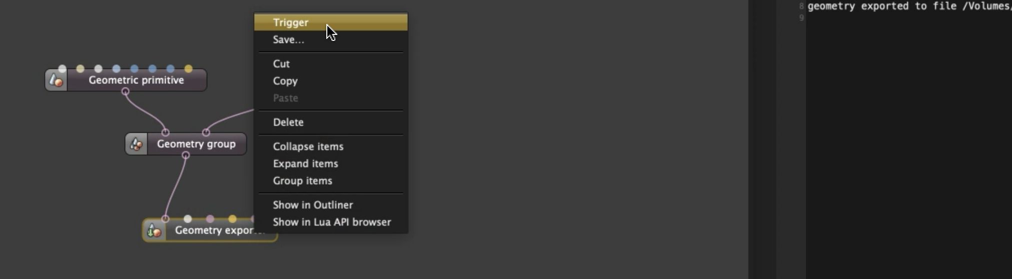

When one inputs a OBJ Mesh node to a a Geometry Export node and selects FBX and a path to write too /user/desktop/xxx.fbx etc.
When does it get "written"?
Does it get "written"?
Posts: 10619
Hi Peter,
you need to right-click on the Geometry exporter node, and choose Trigger:
ciao Beppe

YEEEESSSSSSSS!!!!!!
Thanks man... perfect!
Very useful! Saved my day man.
Have a good one and stay safe
Peter

By the way instead of right click + trigger menu you can also use the trigger button in the Node inspector (green triangle).
