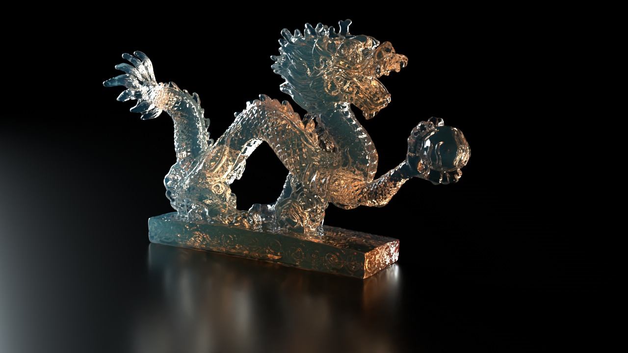

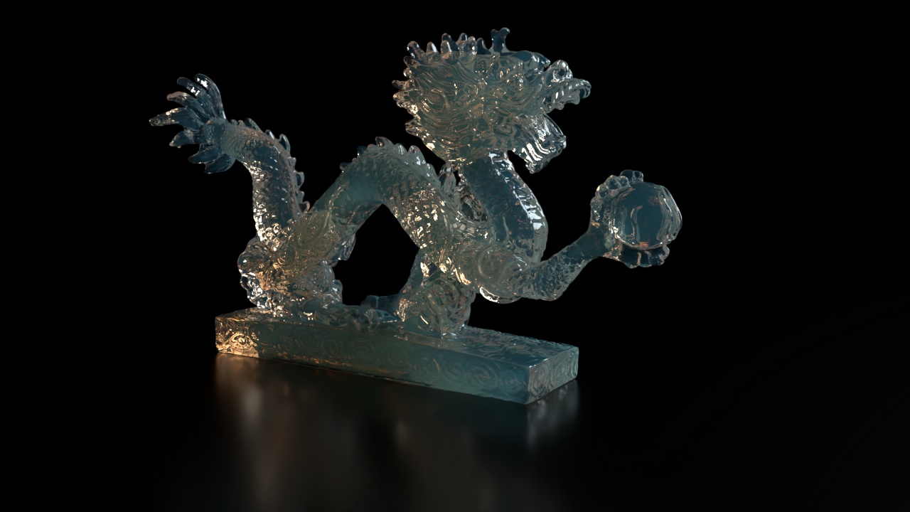

This is simple to create, just use a specular with scattering medium as bepeg4d is saying. Put an orange shade on the absorption and blue on scattering, then play with the density. This depends strongly on the refractive index and the shape of the object of course, not all objects behave the same, thickness plays a big role. Lots of trial error are needed to adjust IMHO. Also maybe combining with some maps to control it selectively.
Please find attached an example scene.

And Really Appreciate the those KlaNDah. The lower version in particular defiantly seems to be in the ball park of the effect. I have a tinker and unpload my results.
