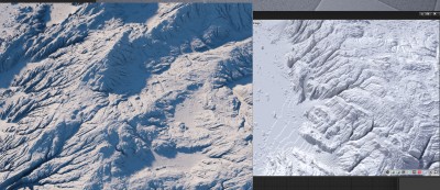

not sure if this is on me or a bug of some kind, alot of time i get nasty banding artefacts on displacement.
the same maps work fine in c4d and blender but in unreal its bad.
tried jpg, png, and tiff.
any ideas?
crackfox
Posts: 367
Joined: Sun Apr 17, 2016 11:52 am
here is an example.
left is c4d and right unreal_

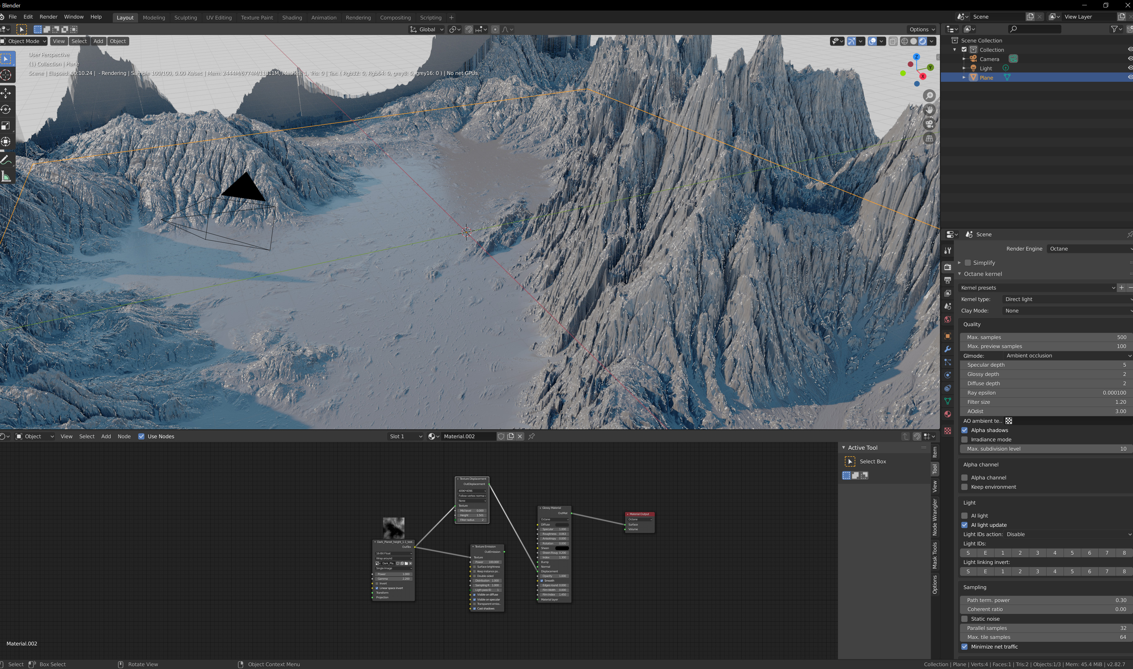

it seems to me that there is a certain compression happening when i import the image but i have tried many formats.
the same file in blender looks fine even when i push the height.
