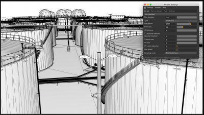

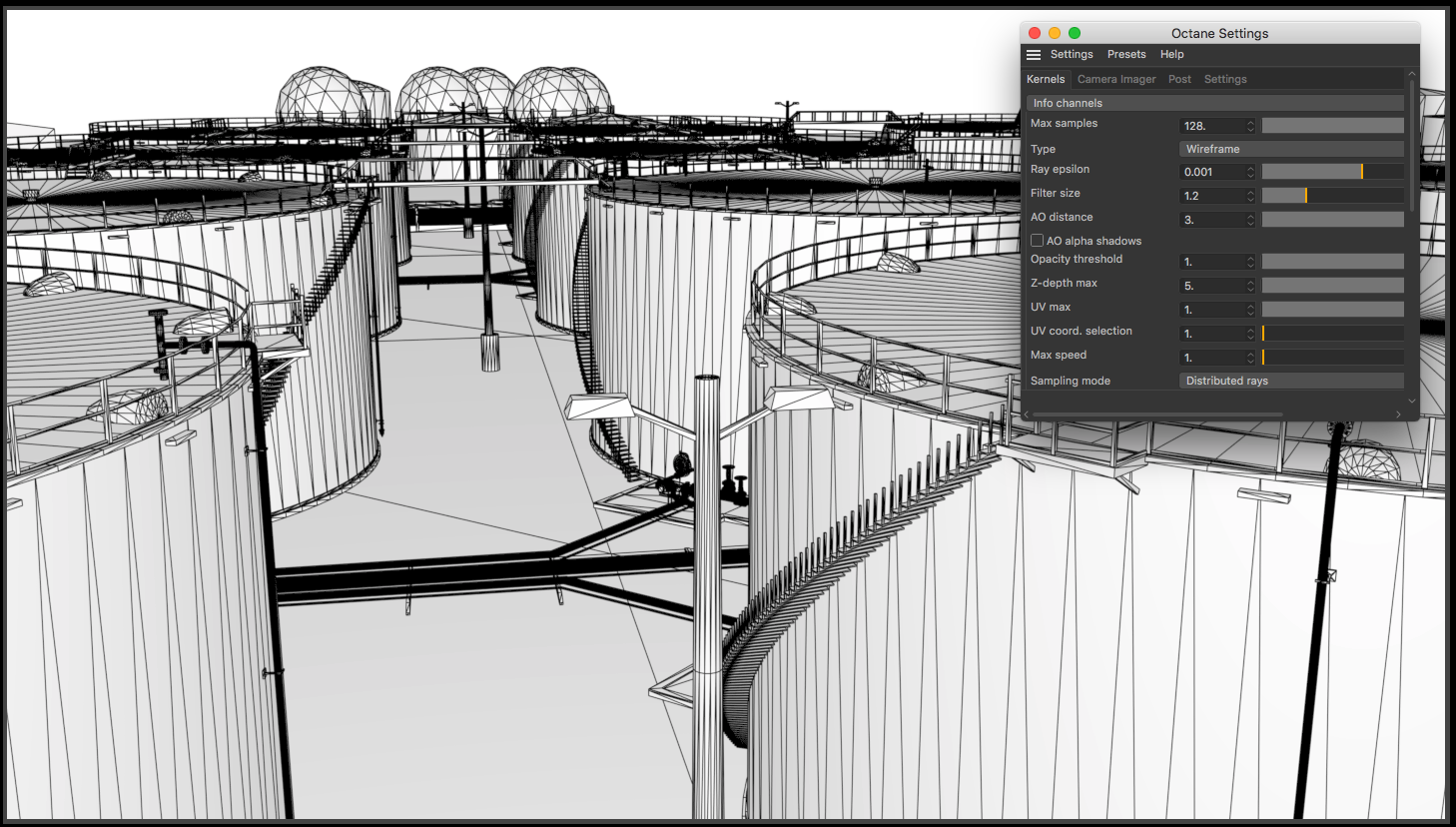

I'm not a Lightwave user, but don't you have the Wireframe option in your Info Channels? If not, you can do it in Stand Alone.
Octane Info Channels>Wireframe

Yes, you can use the wireframe rendering from the infochannel kernel, or perhaps play with the toon rendering.
Thanks,
-Juanjo

just it has a disadvantage, it creates triangles everywhere, it might be good to have an option to have only the edge or shape of the geometries, to get triangles on simple wall geometries square is not aesthetically good visually.
