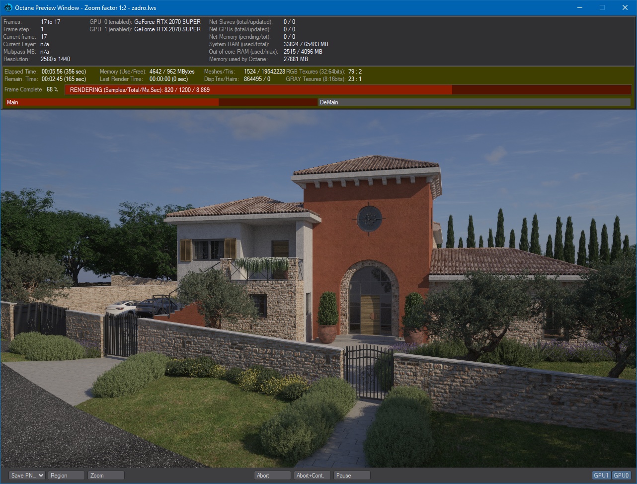

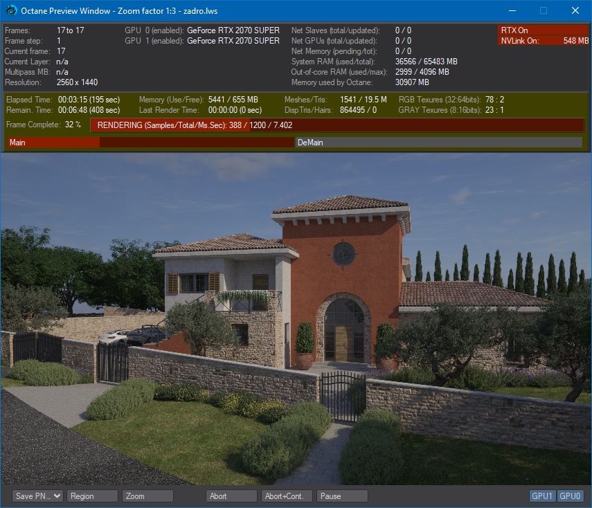

In 2020.1.3.0 it is working but is far from advertised. I didn't expected double the VRAM but this is not even close.
And still not faster then 4.05 even with RTX
8m33s in 4.05 vs 9m41s 2020.1.3
Rendered with 4.05
Rendered with 4.05
Rendered with 2020.1.3

dmodric wrote:In 2020.1.3.0 it is working but is far from advertised. I didn't expected double the VRAM but this is not even close.
RTX doesn’t accelerate texture displacement which seems like a big part of your scene may be using. If you want “RTX on” speed gains, use vertex displacement instead, and try to keep geo in core, otherwise it may be best to turn it off if you are seeing lower speeds than in V4 (2020 is definitely faster than V4 in on 2070, all things being equal).

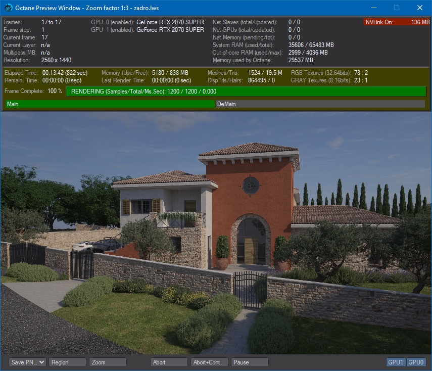

I don't understand what are you trying to say. Given all things equal (all that out of core textures and geometry, displacement maps etc.) 4.05 is faster in that given scene.
Here is the render speed with RTX off.... 13m42s
