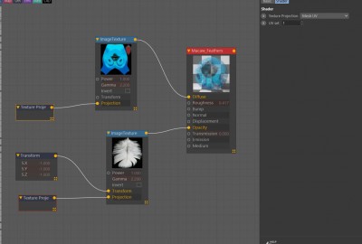

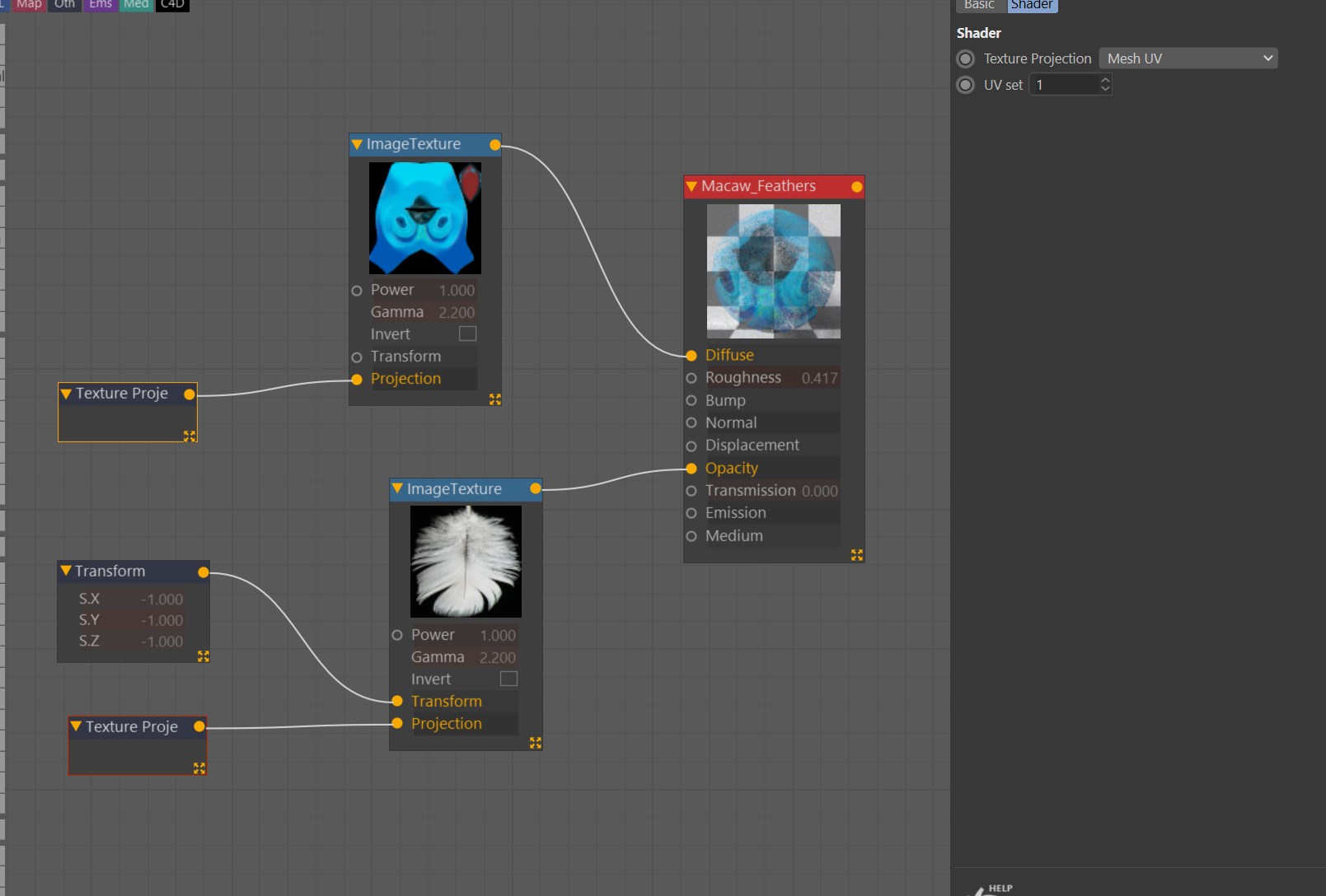

Hello,
I have a big Problem rendering a Fur Character with Feathers. I have created the Feathers with Ornatrix where you can set different UV projections for each Feather/Hair.
Now i need to use one UV set for the Feather Alpha and the other UVset for the overall Feather Color. But the Octane UV projection Node seem not to work. There is an option to choose a UV set. But it does not do anything.
Is this a known bug or do I need to do something special to make this work?

Hi Beppe, thank you for the Reply. It is not possible to export to Standalone. It is a heavy Hairsimulation using Ornatrix Plugin. I dont understand what you mean with "C4D does not handle different UV sets". You can use different UV Tags. I do that very often. Also my setup works with Redshift. I have just spend the day with Transfering the Complete Project to Redshift. In Redshift you can just apply UVsets by Name. It will take the name of the UV-Tag. I wished Octane would be able to work like that as well.
