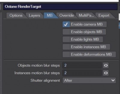

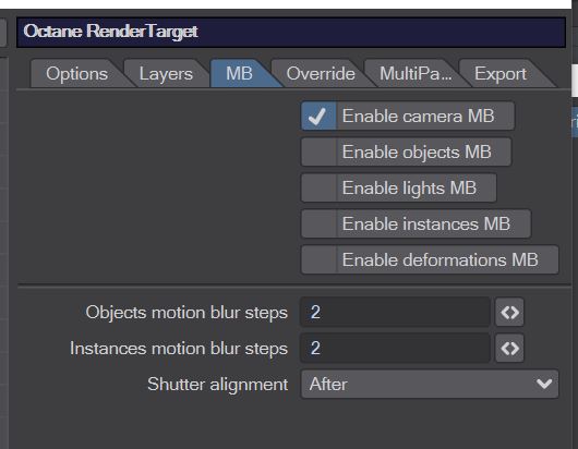

Is the fiberfx motion still computed if you enable only the camera motion blur in the render target root node options panel?

Yes, it still computes FiberFX motion blur data.
