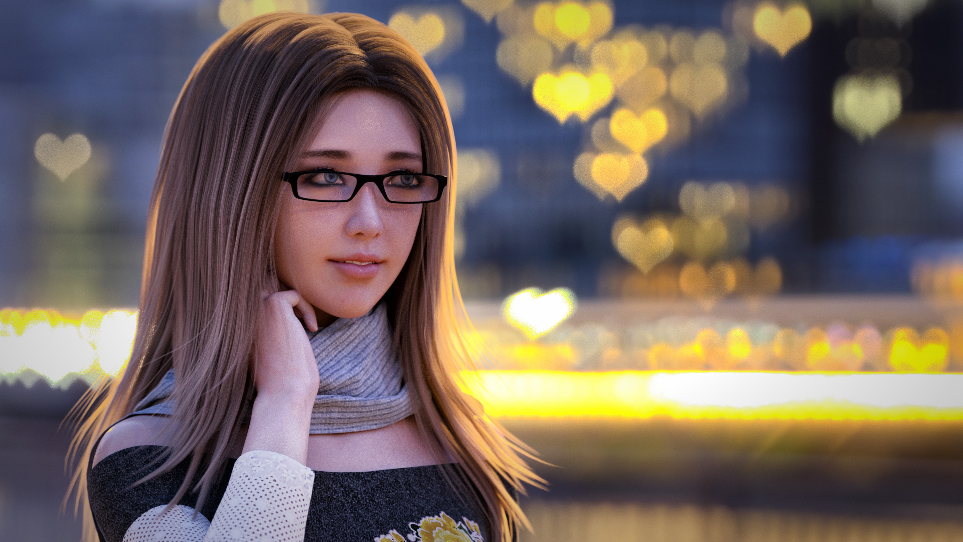

Here is an image I rendered this evening, using a plane with an opacity texture of a heart shaped cutout in front of the camera.

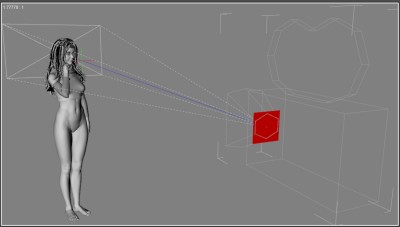

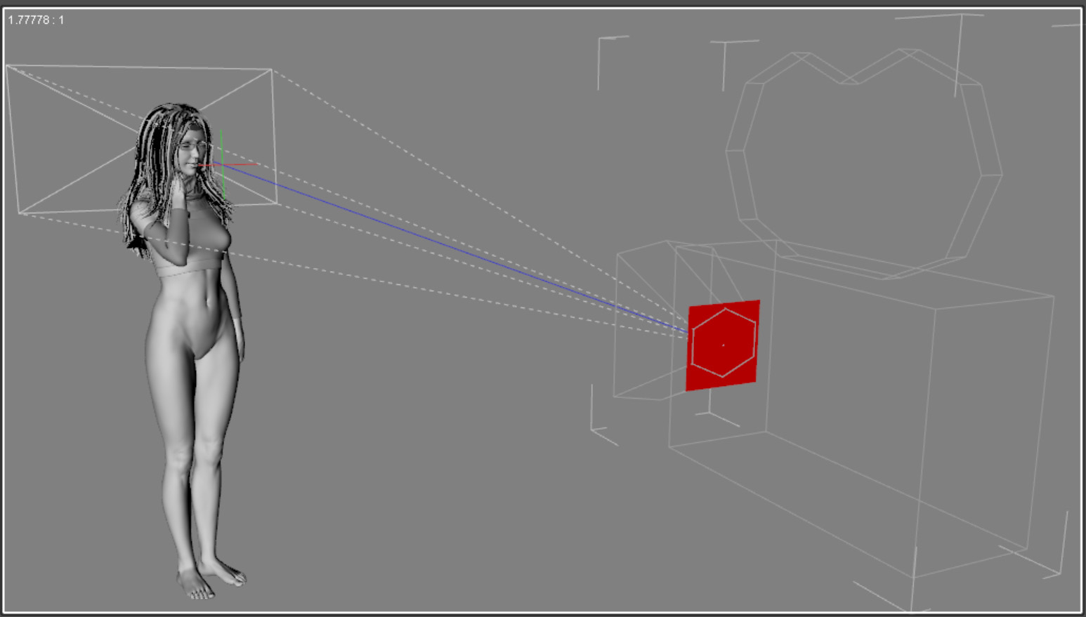

And here is a screenshot of my scene in the Daz viewport - basically Just a character and the camera. The little red square is the plane with the heart shaped cutout opacity texture - just made it red for this screenshot so it's easily visible.

One caveat I've found so far is that you can't use the AI Denoiser when doing this. I don't know why, but despite the raw render looking like what I posted above, the denoiser beauty pass would always output perfectly hexagonal bokeh. Maybe the AI algorithm thinks it knows what the bokeh should look like based on the camera settings and ignores the effect of the plane in front of it? Possibly a bug, but also fascinating that it completely changes the bokeh appearance.
