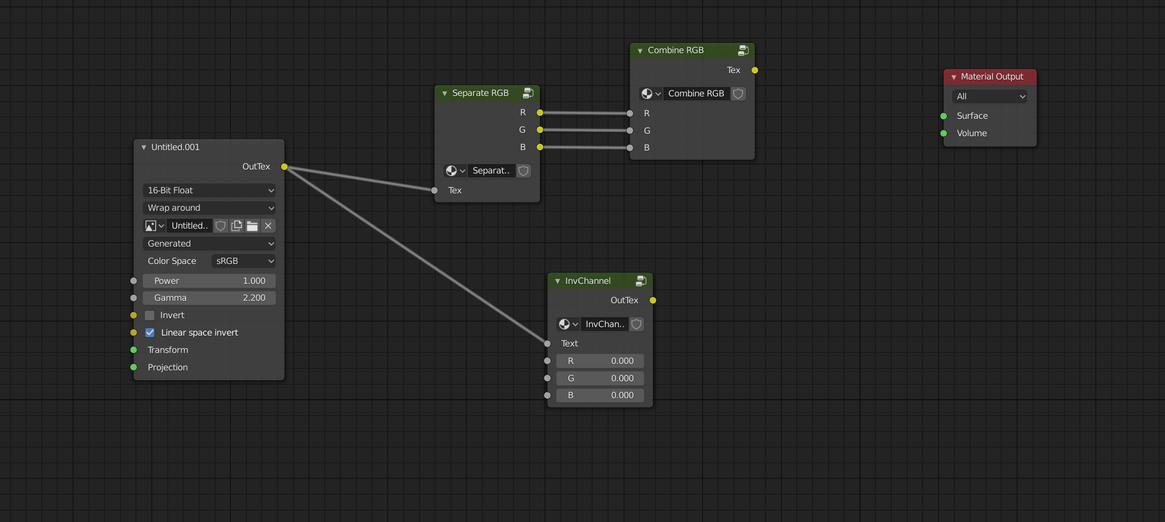

Per channel texture control nodes, no OSL or LDB, user frinedly, .blend file included.
Just leave it here, may be helpful to someone.

kabakZ wrote:Per channel texture control nodes, no OSL or LDB, user frinedly, .blend file included.
Nodes.blend
Thanks for sharing this, but looking at the grouped nodes, the network is not providing the RGB channels (multiplying an image by a pure red color is not providing the R channel of the image).
If you extract a channel, you'll get a gray level image, which is different for any channel. Just try with Cycles's SeparateRGB node or with the OSL node for Octane.
