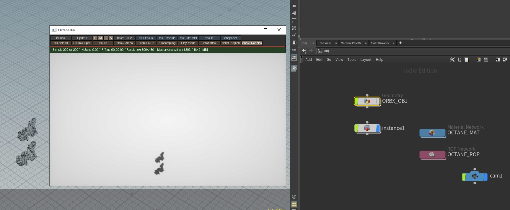

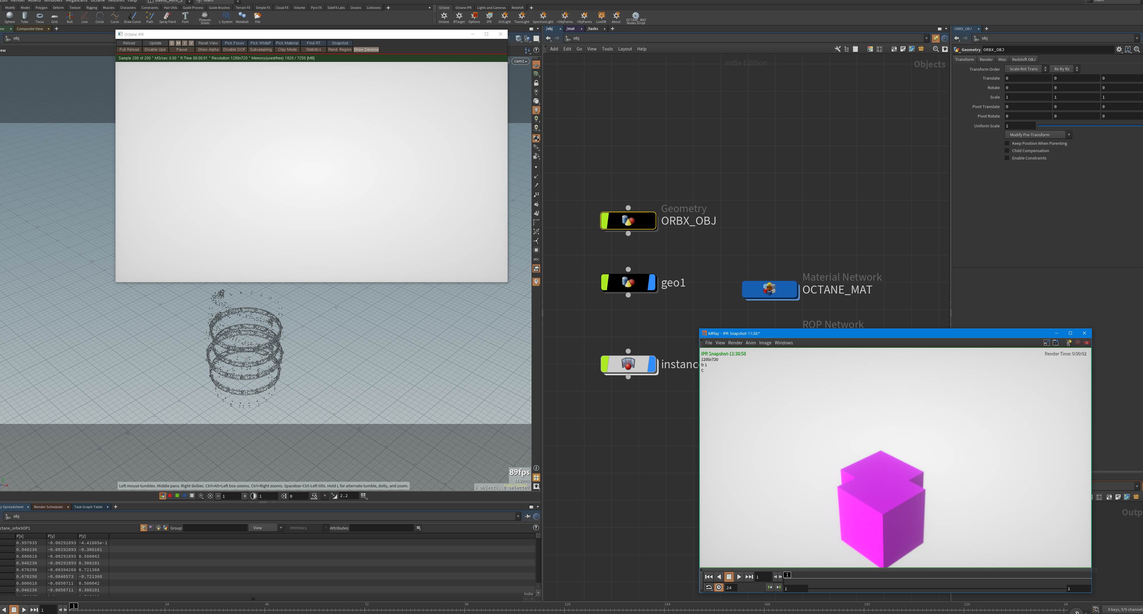

I've tried, I load an orbx in a geo node, I load the orbx in another geo node with an object merge and put this last geo node in instance object, the first ersult is boxes and when I change display mode to point nothing ?
Here is my hip file

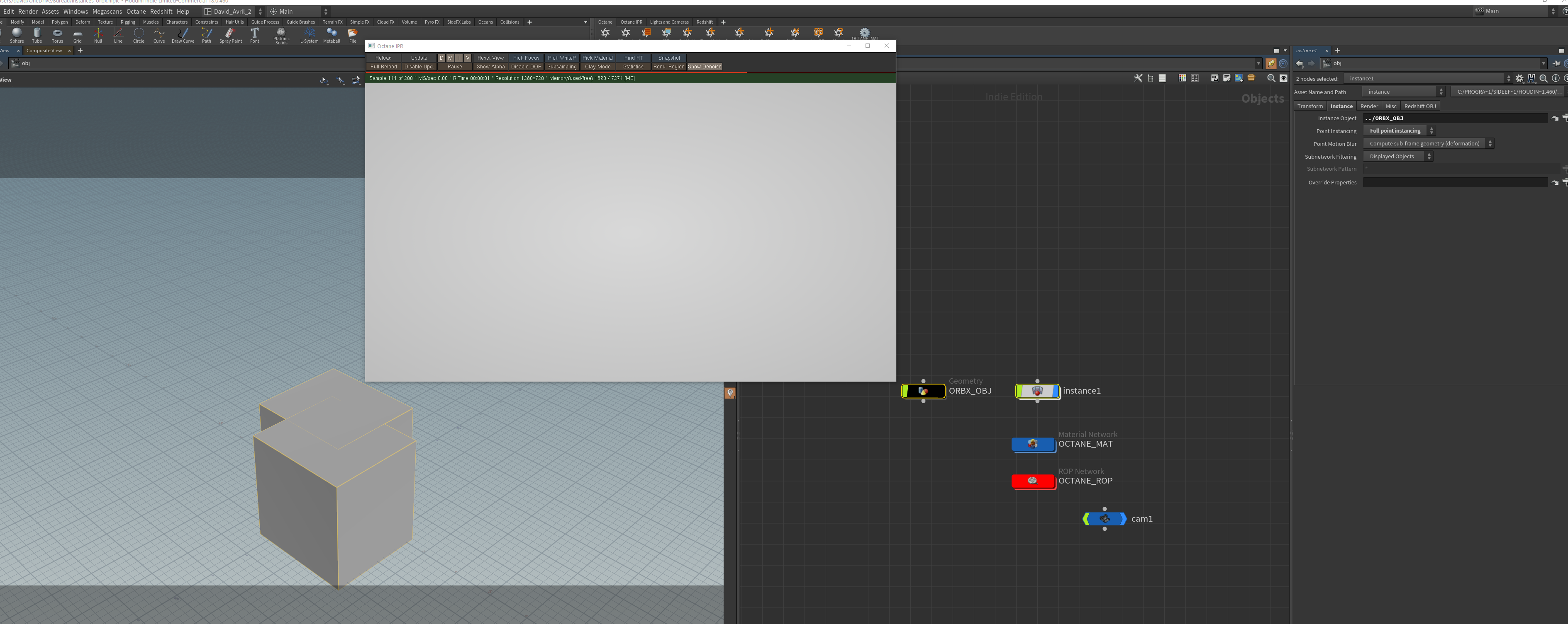

That's what Ii've done with no success
instances_orbx.hiplc.zip
(43.05 KiB) Downloaded 164 times

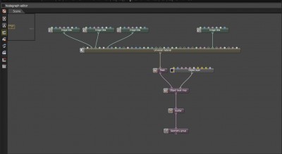

juanjgon
Posts: 8867
Location: Spain
Ok. To instance this proxy you need to clean the scene node tree in the Standalone, as you can see in the attached image. The full node tree including a render target is not compatible with the Octane instancing.
Hope it helps,
-Juanjo
