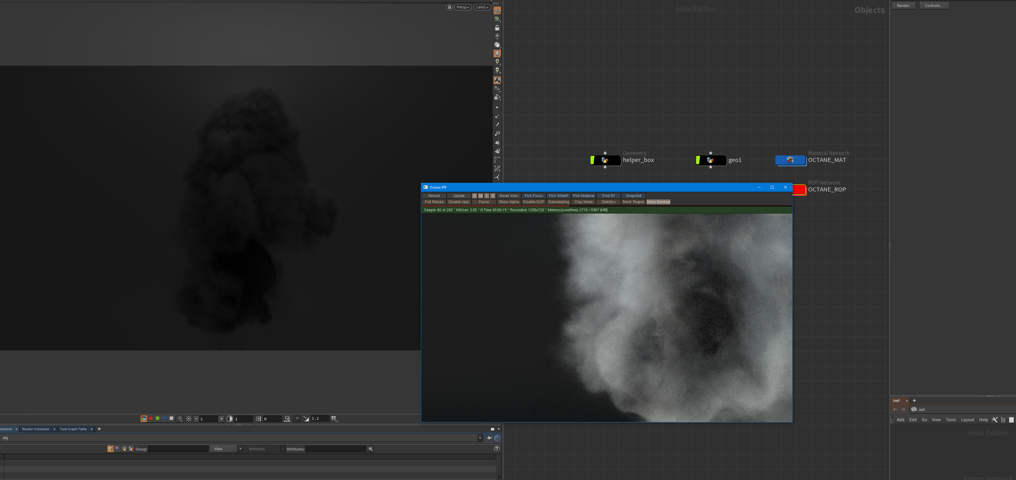

When I try to render my scene the camera in IPR or in render not use my camera framing

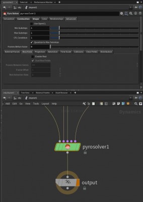

You need to disable the rest grids in the pyro solver, or delete them before trying to render the volume. The problem comes from the fact that these grids don't have the same voxel size or resolution as the other grids, and currently, Octane can't process volume objects if the grids don't have the same resolution.

Thanks so much Juanjojuanjgon wrote:Hi,
Thanks,
-Juanjo
