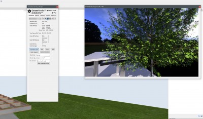

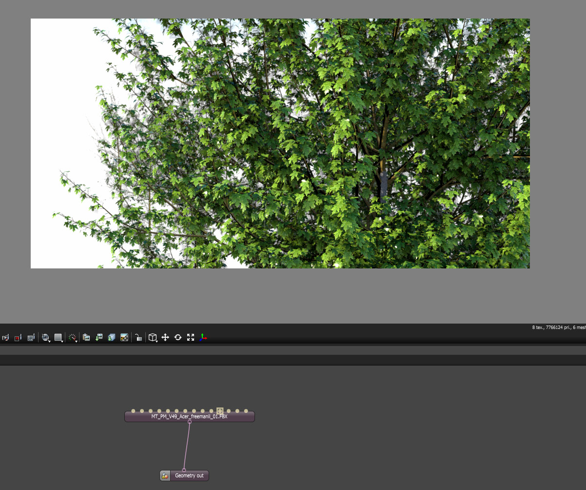

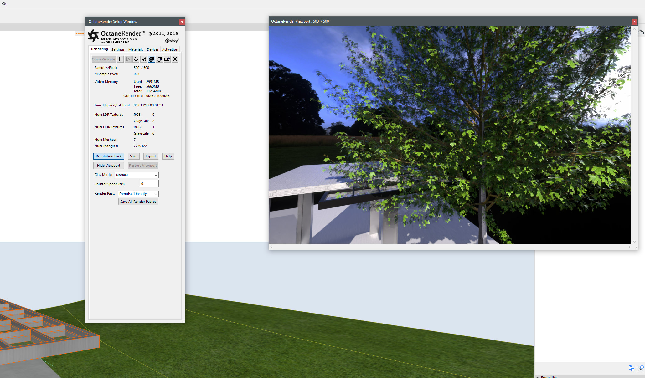

- See attached two images, one of an orbx tree in standalone Vs the same tree as a proxy in Archicad plugin; same material, lighting settings (even adjusting lighting), and the tree looks terrible in the Archicad version... any thoughts?

Archicad Octane Render
Standalone Octane Render
Unsure. However try adjusting Kernel->Ray Epsilon. ArchiCAD generates both large and small polygons, so it is sometimes difficult to get the right value for the Ray Epsilon. Also - the Standalone render looks like it has a Texture Environment, whereas the ArchiCAD render potentially has a Daylight environment which might be causing more shadows.
