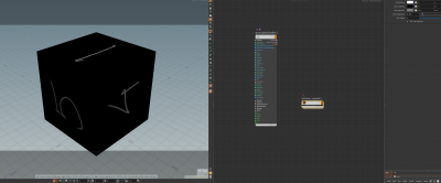

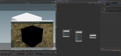

I've tried to render a simple object with UDIM works well with Mantra but with Octane all is black ? any idea ? Even if I cjange the grid size always black

How are you declaring the texture file? Octane works using the <udim> or <uvtile> tags. If you want to share this scene, I could take a look at it here.

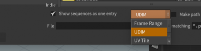

Ok thanks for the infos :)
IMO a little thing in the open dialog box could help like with Mantra or Redshift ;)
