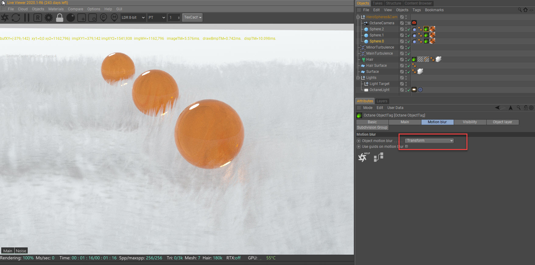

Hi
I can't see any problems, there's a wrong impression how It works. You should activate motion blur for spheres too. Then plugin will export keyframes for spheres when you do this, and relative movement will be zero. Otherwise it thinks spheres are static and gives blurred effect. See image

Here is a quick rendering of the shot, given the setting Ahmet recommended.

Interesting- with those settings the final render does appear correct but scrubbing the timeline and looking at the Live Viewer the motion blur is still incorrect. Thanks for the support on this everyone.

scrubbing can give correct or nearest look if you do it frame-by-frame. Also restarting the render on LV that will give correct look. Probably you didn't read motion blur section notes from c4d manual. Wrong results happen if you randomly jump between frames because it works like caching the framesjames_conkle wrote:Interesting- with those settings the final render does appear correct but scrubbing the timeline and looking at the Live Viewer the motion blur is still incorrect. Thanks for the support on this everyone.
