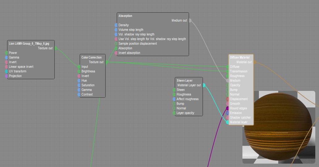

The setup is simple. One Diffuse Material and one Secular Material node. The Diffuse Material node provides the color and sheen and the Specular Material node provides the highlights and translucency. The definition of the shader is slightly different from the wolf fur shader I had used to render the wolf as shown in viewtopic.php?f=44&t=73819#p383530. Like I had said depending on the color of the diffuse material / texture some adjustments may be needed.

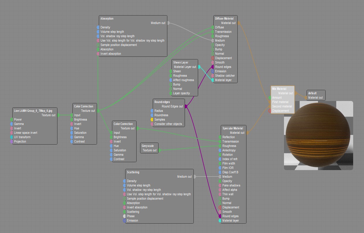

The Diffuse Material node is fairly simple. I used the LAHM hair texture that came with the lion and just adjusted a bit to enhance it to my liking using the color correction node. This Color Correction node you will have to adjust to your liking. I then simply plugged it into the Diffuse pin and Transmission pin of the Diffuse Material. Next I added a Absorption Node and for the Absorption pin I used the same output from the Color Correction node that I used in the Diffuse Pin. I Invert absorption so that the color absorbed is the opposite color of the texture and the final result is the color of the texture. It may be not very apparent with the texture I am using (or with what you might use) but try as an experiment with a solid color like Red and see what invert absorption - ON / OFF does. As the hair stand is very thin, I used a Density pin of .1. You can experiment with different values here. I used small value as i wanted translucency. Finally I added the sheen. This again you can adjust to your taste. For me I kept the Roughness pin to .3 and Sheen pin to RGB 72 72 72.
Diffuse NGE
Diffuse NGE

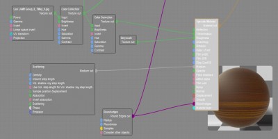

Next was the Specular Material Node. This also has a fairly simple setup. In this I used RGB 255 244 218 as the Highlight pin color so that the highlights were not pure white (Slight yellow tint). Again you can experiment and see what you like. For the Transmission pin, I used another Color Correction node that took the output of the Color Correction node that I used with the Diffuse pin, as input. I wanted more transmission so using it I brightened it up a bit for the face fur. Roughness pin I set to 1 as I wanted the highlights to be fully spread along the hair stand. Also on such thin geometry as a hair strand, using 1 gave a better result than setting it to a low value. You can set it to .1 etc. to see the affect it has on the highlights. I finally added the Scattering node to complete the SSS. In the Scattering node I kept the Density pin as .1, Absorption pin as RGB 0 0 0 and Invert Absorption as ON. You need to do this other it affects the output. If you OFF it, you will see an immediate affect on the render. You can experiment on this to see how it affects the output. For the Scattering pin I used RGB 255 255 255 and for the Scattering direction pin I used -0.75. Once again you can experiment with these values to see how things change in the render.
Specular NGE
Specular NGE
Finally I mixed the Diffuse Material and Specular Material mode with a Mix Material node and set the Amount pin to .7 (70% mixed with 30% Specular).
Full NGE
Full NGE

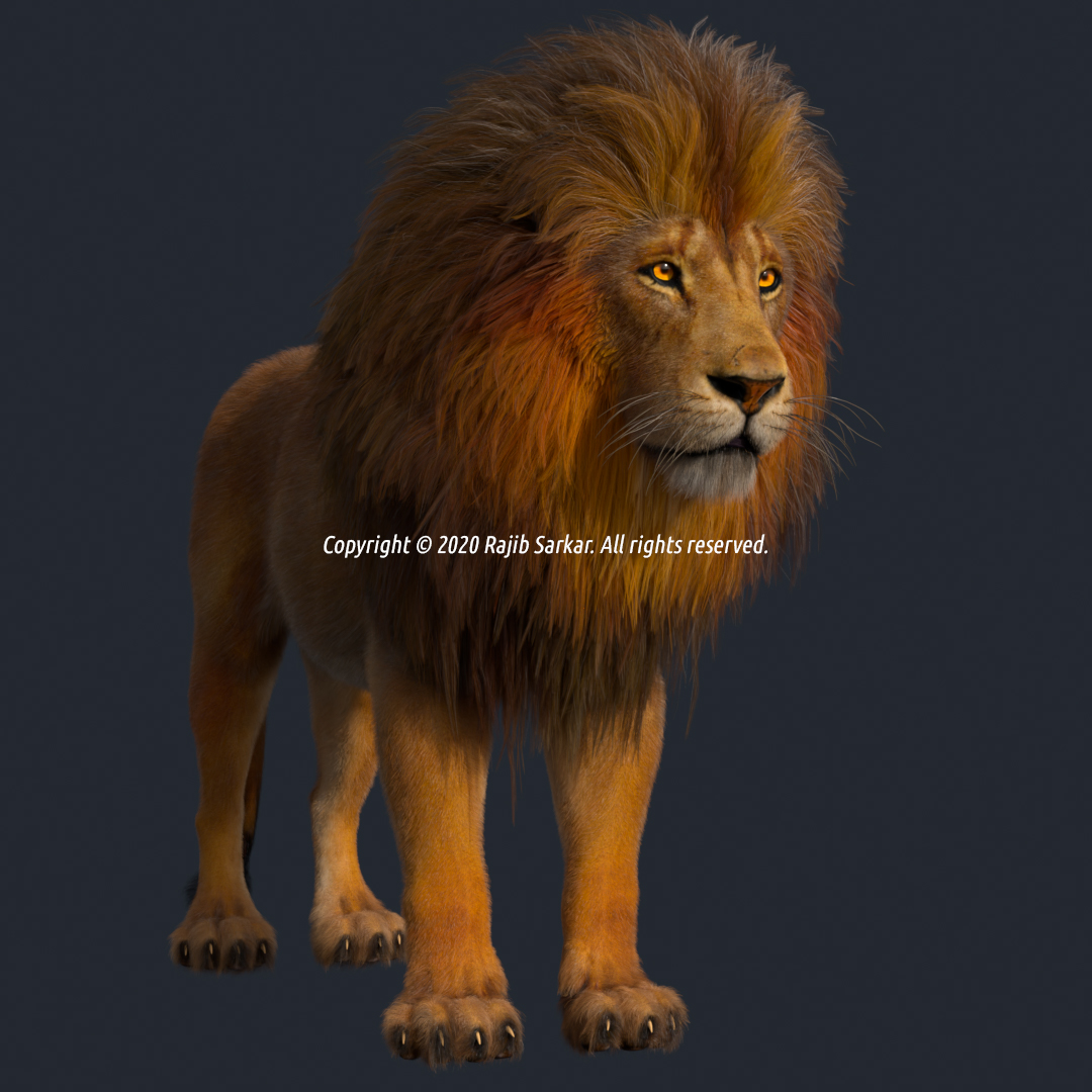

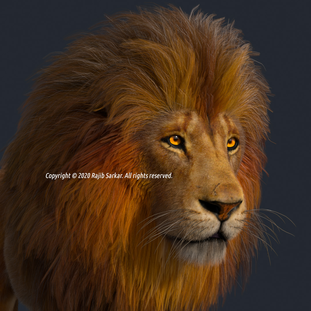

The Lion had 4 fur group. So I applied the same definition to all 4 and then tweaked individual once as needed. One other thing you need to take into account is the lighting. I am using a VHDRI (Very high dynamic range image) so the light quality is excellent. Hence the render looks good. Your lighting will definitely affect what result you see so I would recommend using HDRI instead of the Octane Daylight. Also you at least need to use Path Tracing as the Kernel. I also use higher Diffuse depth / Specular Depth / Scatter depth (Under Path Tracing in the Rendersettings Tab) than recommended. Mine is set to 48, 48, 256 respectively. It may be too high but for my rig, the rendering is still very fast. The renders you see here took around 30 seconds at 1000 samples for 1080x1080 images. I do have 4 Titan RTXs.
The SSS effect will be more apparent if the light is behind the Lion. Here I did not do that. The light is just to the front left and front right of the Lion from front.
Following are the sample images I made:
Light from front left of the lion :
Lion - Full

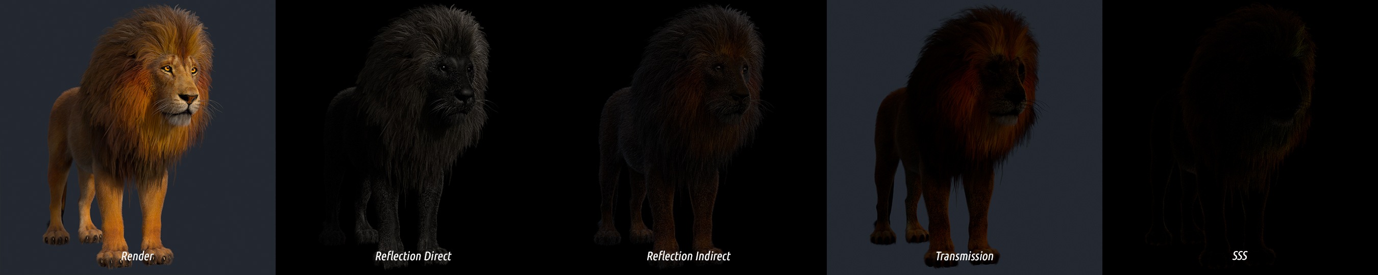

Render Passes for lion

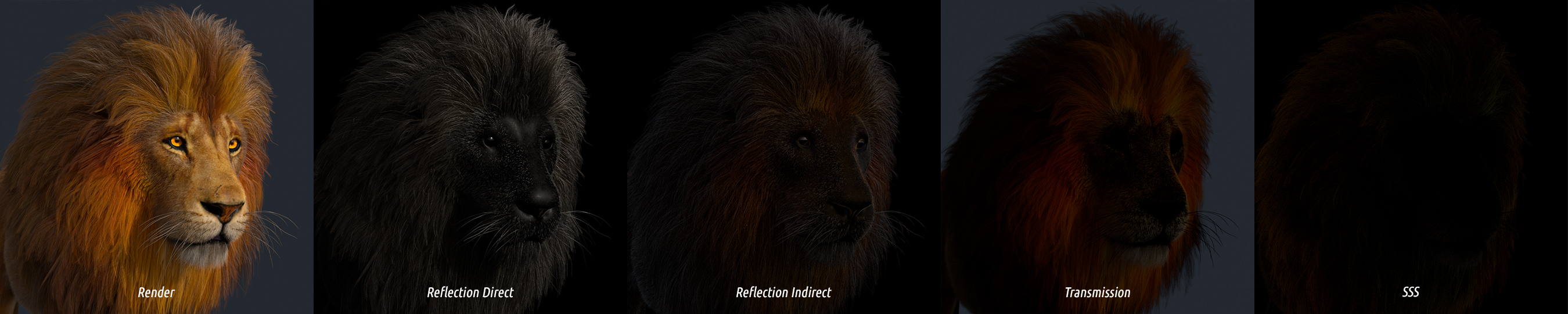

Render Passes for face closeup

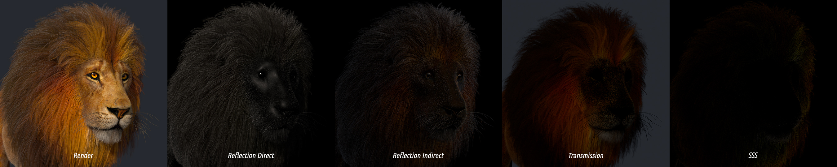

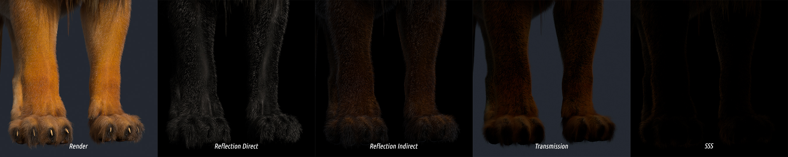

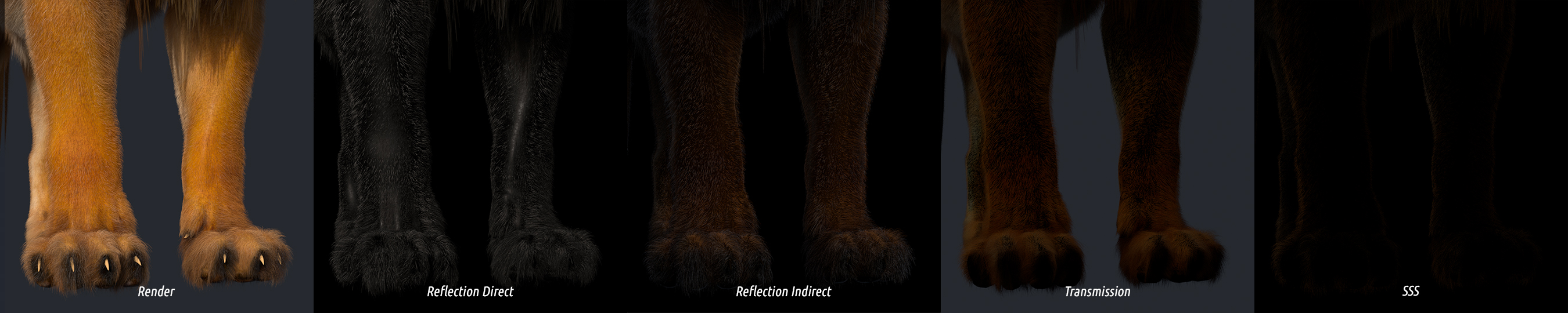

Btw. always use render passes like Reflection / Reflection Direct / Reflection Indirect / Transmission / SSS etc so that you can actually see how the light is affecting the material you are using. This is specially helpful when you are trying to build your own material. I use a lot more of the passes. I will create another post to show how and why I use them.
