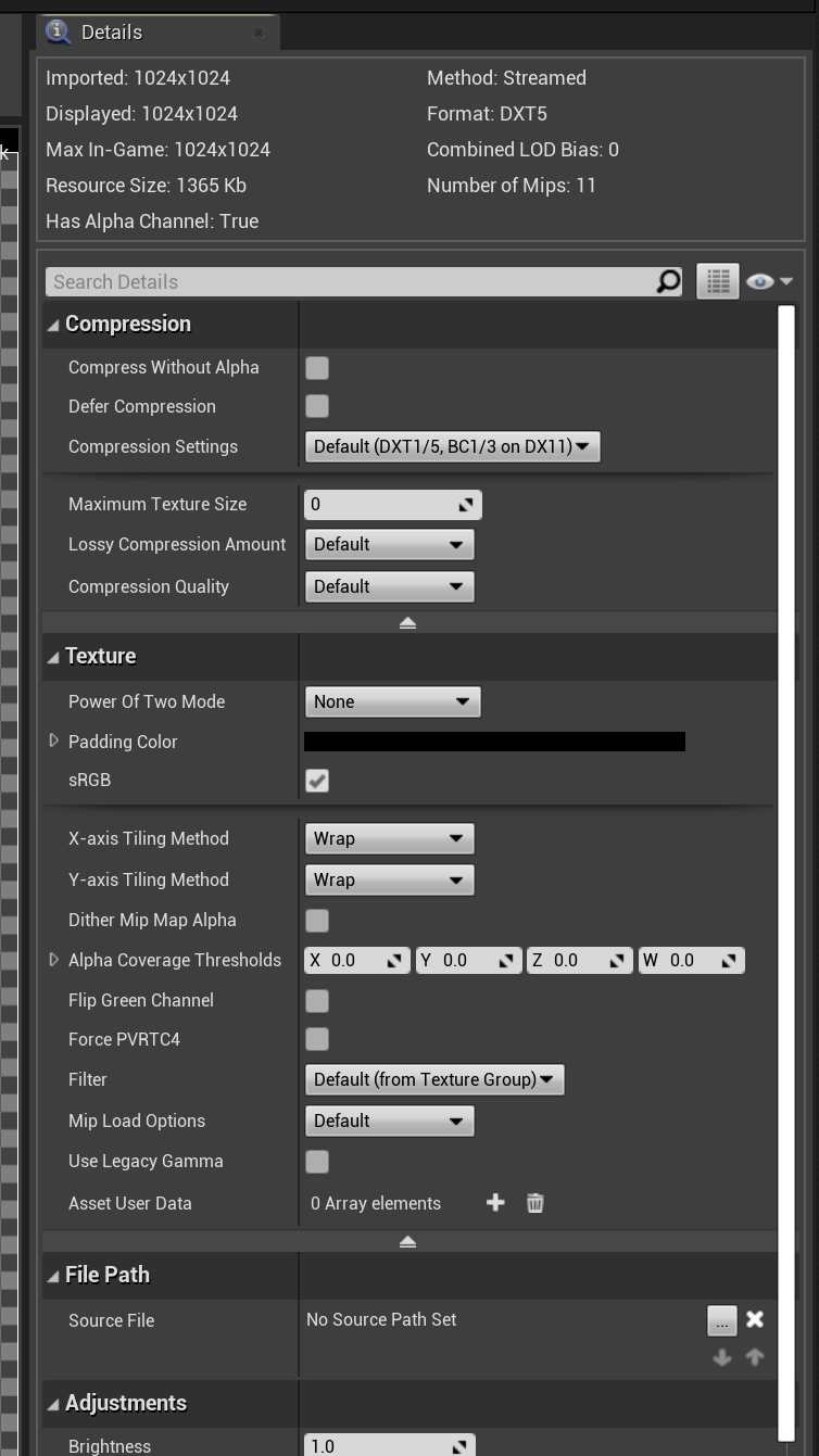

ChrisHekman
Posts: 1165
Joined: Wed Jan 18, 2017 3:09 pm
EvolverInteractive wrote:Targa are multi channel and some of the first supported in games. Lots of use in the UE3 days.
Unreal converts them to unreals internal format, so they stop being targa's after import.
I tested the same material setup with this type of unreal texture:
Could you share your texture details?
Are you using the latest 0.36 version?
