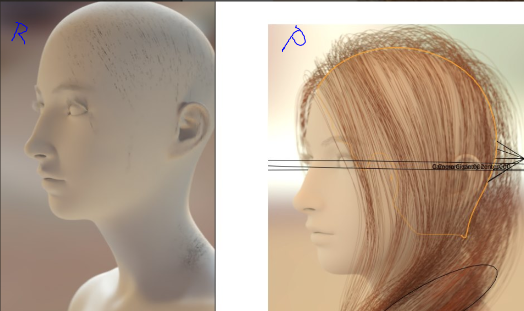

I have seen some amazing Octane hair, and I am trying to do a little hair for a client project. Nothing fancy, but having a real struggle. Preview and Render are way off.
Looking for guidance on how to have Preview Render Hair match Render Hair.
Please see attached.
Any help appreciated.

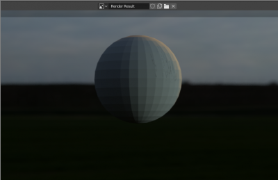

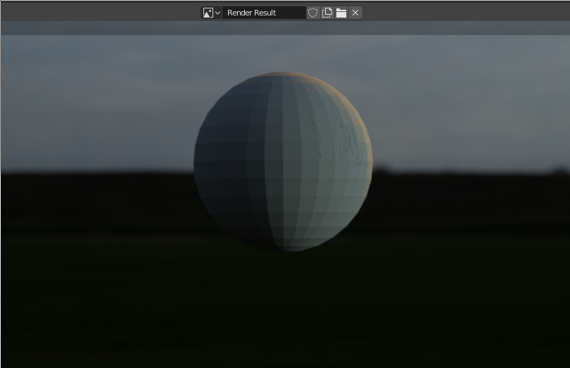

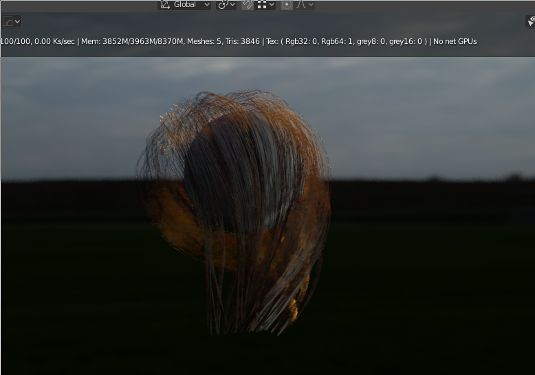

grimm
Posts: 1332
Joined: Wed Jan 27, 2010 8:11 pm
Location: Spokane, Washington, USA
I'm getting the same results that you are...
Viewport:
Rendered:
Version 21.7

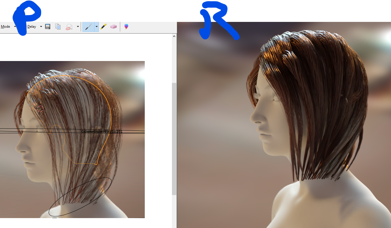

J.C
Posts: 1874
Joined: Thu May 13, 2010 6:35 pm
Location: Wrocław
You must enable "Show emitter " in particle render settings.
To adjust the look of the hair play with Root and Tip thickness in Octane hair settings which is located below hair/particle settings.

protovu
Posts: 476
Joined: Thu Sep 11, 2014 7:30 pm
OK....much better, but I am still working in the dark. That is , Preview does not match Render.
It is supposed to match, correct?
Any advice appreciated, thank you.
