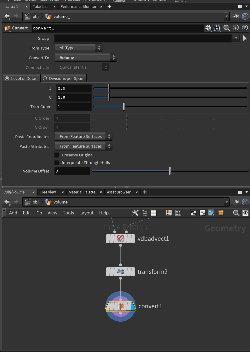

If I add a transform to a volume the IPR/Render displays the volume in the incorrect space.
https://share.getcloudapp.com/7Ku0llQv
gif of the error.
simple scene with the bug.
https://share.getcloudapp.com/o0ugll5j
juanjgon
Posts: 8867
Location: Spain
I'm investigating several issues with the vdb transformations right now. I hope to have a fix for these issues soon, but meanwhile, usually, the workaround is to convert these vdb primitives to volume primitives (that BTW are also extracted by the plugin a bit faster) or to export the final vdb primitives to OpenVDB files that can be loaded by Octane at the render time.
