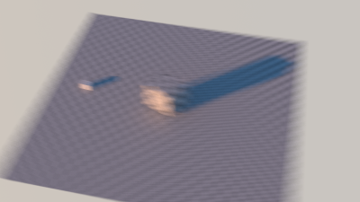

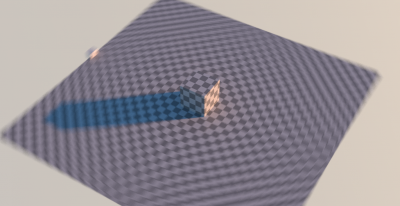

Found a problem with camera motion blurt though. Based on the rotation of the camera the center of the plane should be non blurred. But octane does not do it properly.
I baked the camera to keyframes as I thought maybe its because of the parenting. But no luck either.
Hopefully this can be easily fixed by some setting.
Cheers,
Raphael

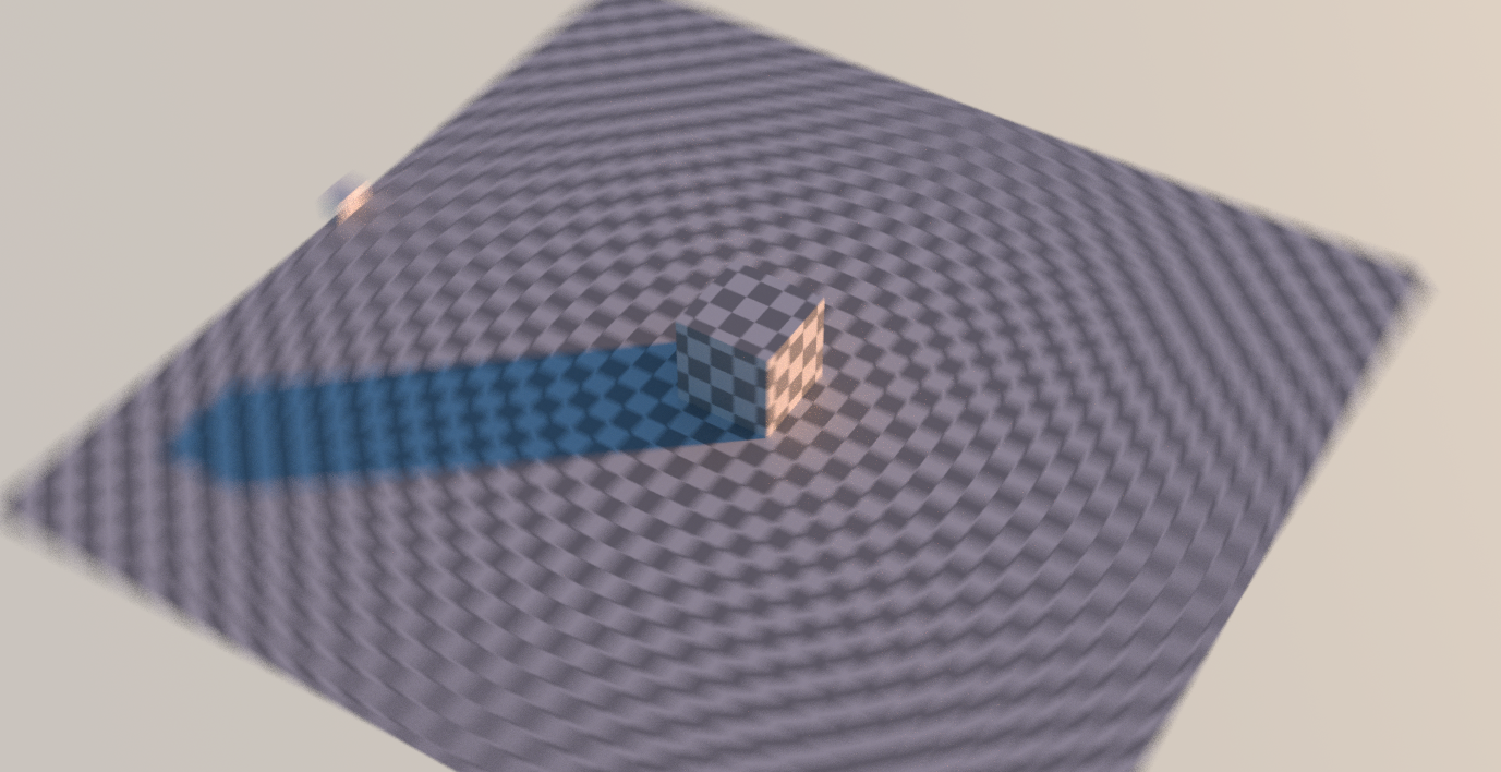

Looks like it's Blender's plugin bug. In Standalone it renders as expected.
Standalone render:

Definitely something to fix! Thanks!
linograndiotoy
Posts: 1538
Fixed in the internal build.
