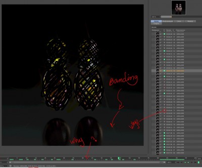

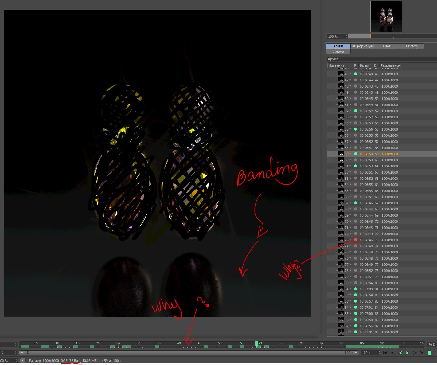

the first frames after a while banding
here you see the problem.
I add noise to my floor material
decreased the light to a minimum
when I start rendering animation everything is fine, after, I don't know 25 frames start banding.

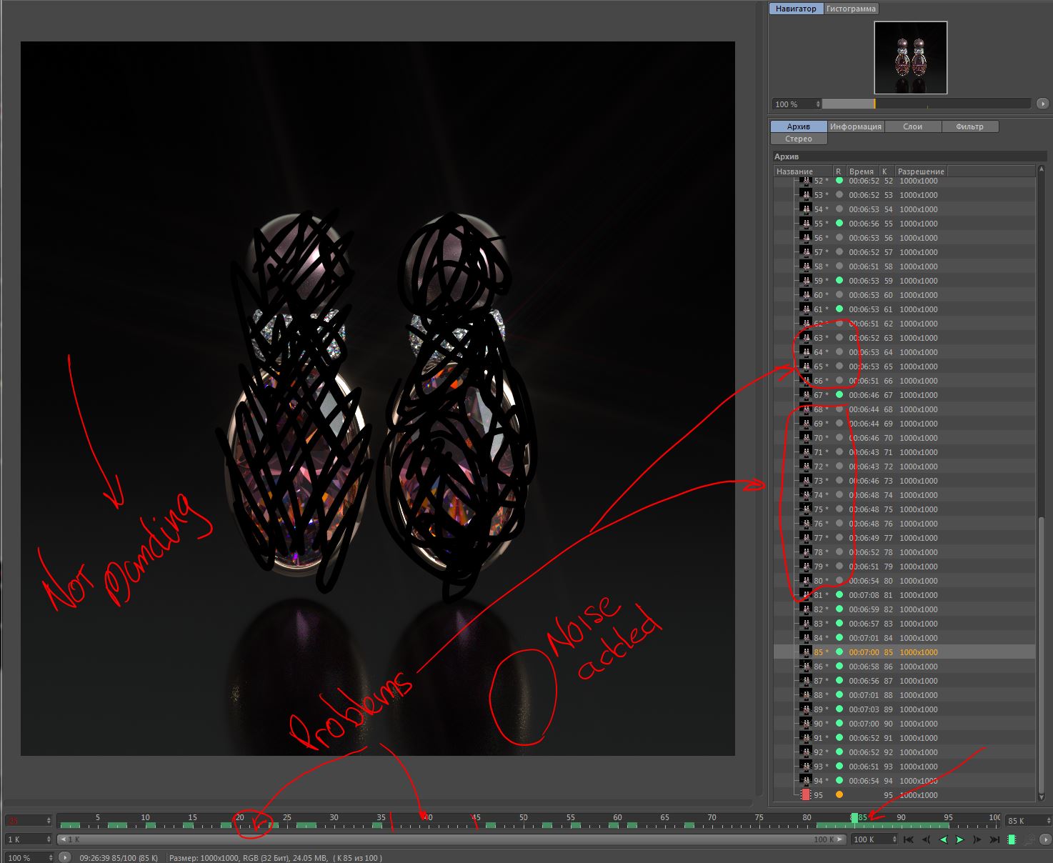

some of the lastes frames looks fine
you see that at the bottom looks like some frames are not rendered. ( they are there but with problems)
you can see last frames are fine until the animation is finished, after saving them all with banding issues

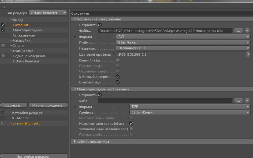

here some details
here some details
here some details

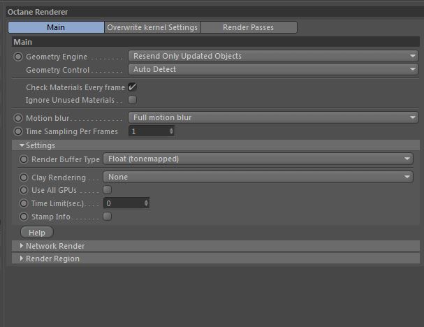

buffer -tonemapped--- path tracing

Posts: 10550
C4D has a limited memory assigned to Picture Viewer, the green dot indicates that the frame has been loaded in memory, while the gray dot means that it is not.
So, nothing serious, in my opinion.
About the settings, please, always use the Geometry Control set to All Object Movable, instead of Auto, and, most important, don’t save you animated render directly in AVI or MOV or any other movie file format, but always save your frames in PNG or EXR sequence.

Posts: 10550
Yes, if you save directly in a movie format, the frames are compressed during saving, and the quality is lost (banding effect, coloring, and so on).
Save the frame separately to preserve the quality.
