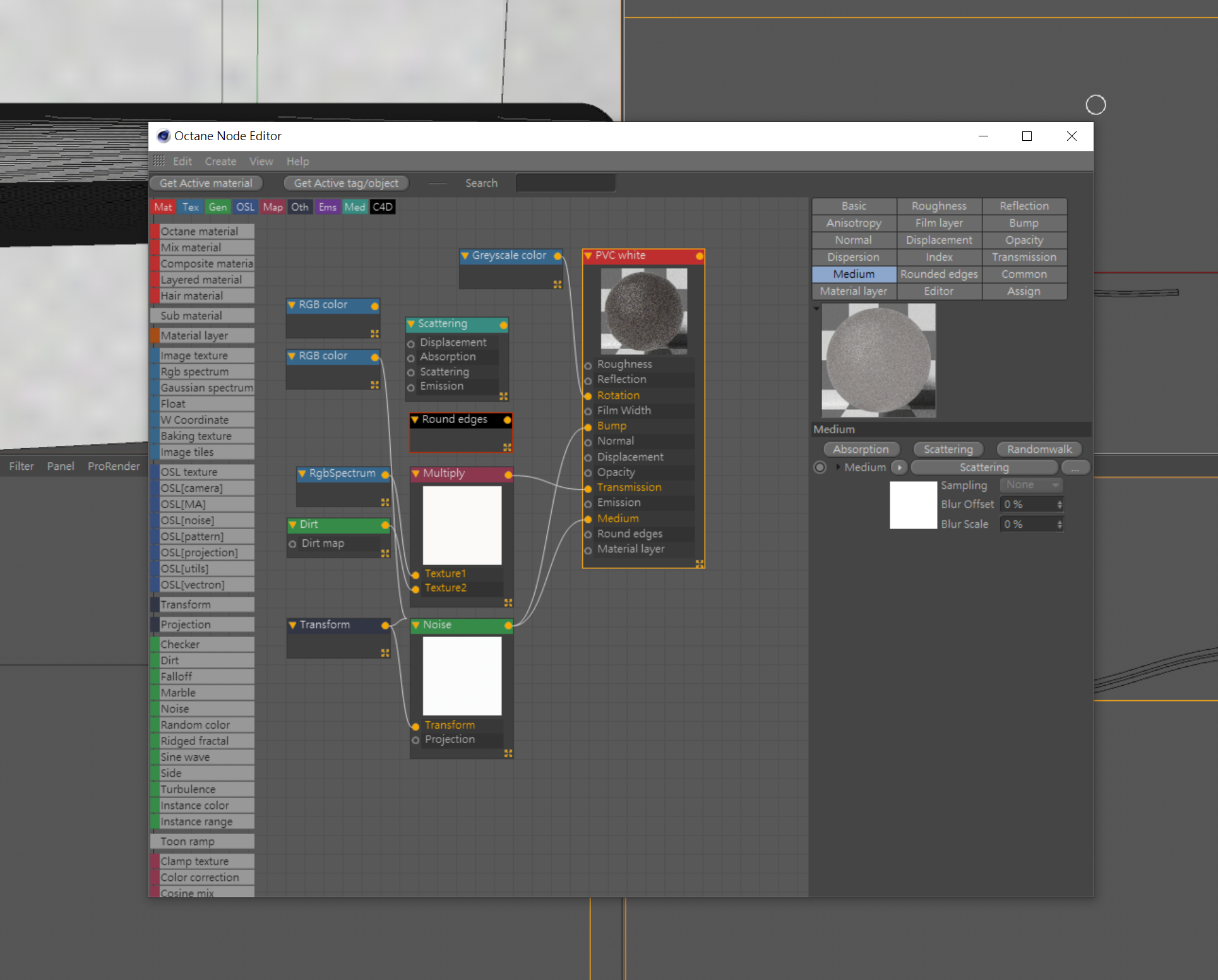

after upgrade to 2020, I notice that there're some bugs on node editor. Please see attached pic, medium channel connect to noise and there're no nodes connect to scattering node. Actually it's functional (you can see it on material panel). auto-arrange cant get it right even reconnect. Normally, node editor is functional but sometimes it happens.
is anyone have this problem? or how do I fix this? please let me know

Pls try this build
viewtopic.php?f=85&t=74603
connection line problems are due to new nodeID changes. It should not give problems with latest build. But how did you created these nodes? And how this happen?borsan wrote:yes i'm using this one
