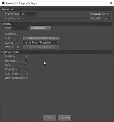

imported alembic animated spline to c4d, dropped Octane Object tag - and I see that "Hair" tab is missing.
If i hit "C" to convert alembic spline to a static spline, "Hair" tab appears and renders fine.
Does it mean you can't render animated splines as hair in Octane / C4D?

It doesn't recognize as spline, that's the reason why the hair tab invisible.

luminouspowerhouse wrote:Ok, so are you saying it's impossible to render alembic splines in C4D / Octane?
I'm saying it doesn't recognize it. Impossible is different meaning for me!
You can do some work-around, also if I try to simply add this option to tag it's rendering. Tested!
Now you can try to import as hair and render.

No but look this

thank you for prompt reply, sadly it didn't work :( I will have to figure something out
Posts: 16068
Location: Türkiye
luminouspowerhouse wrote:thank you for prompt reply, sadly it didn't work :( I will have to figure something out
why? it's working on me! What it gives you?

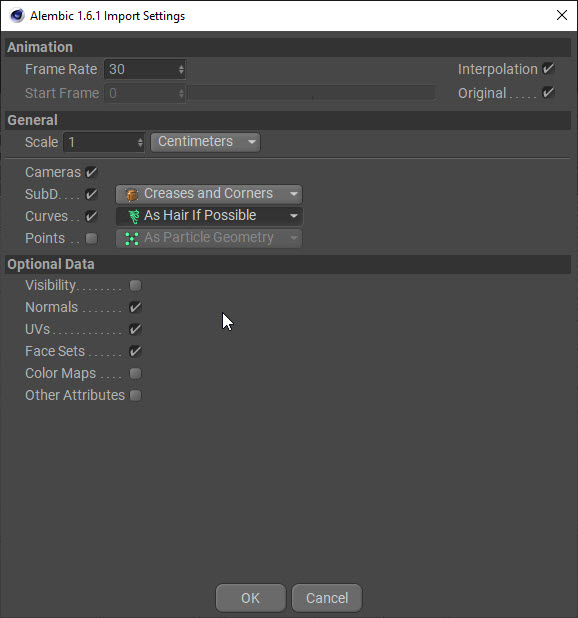

Guys, here's a test, when i have several splines in one abc, Cinema DOES NOT import it as hair
If i only have one of the splines, it DOES.
What would you recommend as a workaround?
Here's two example files
