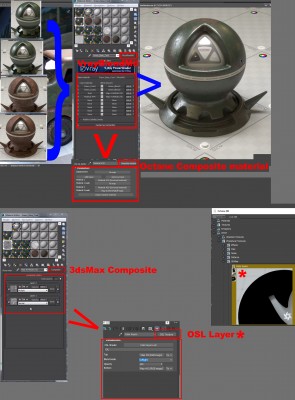

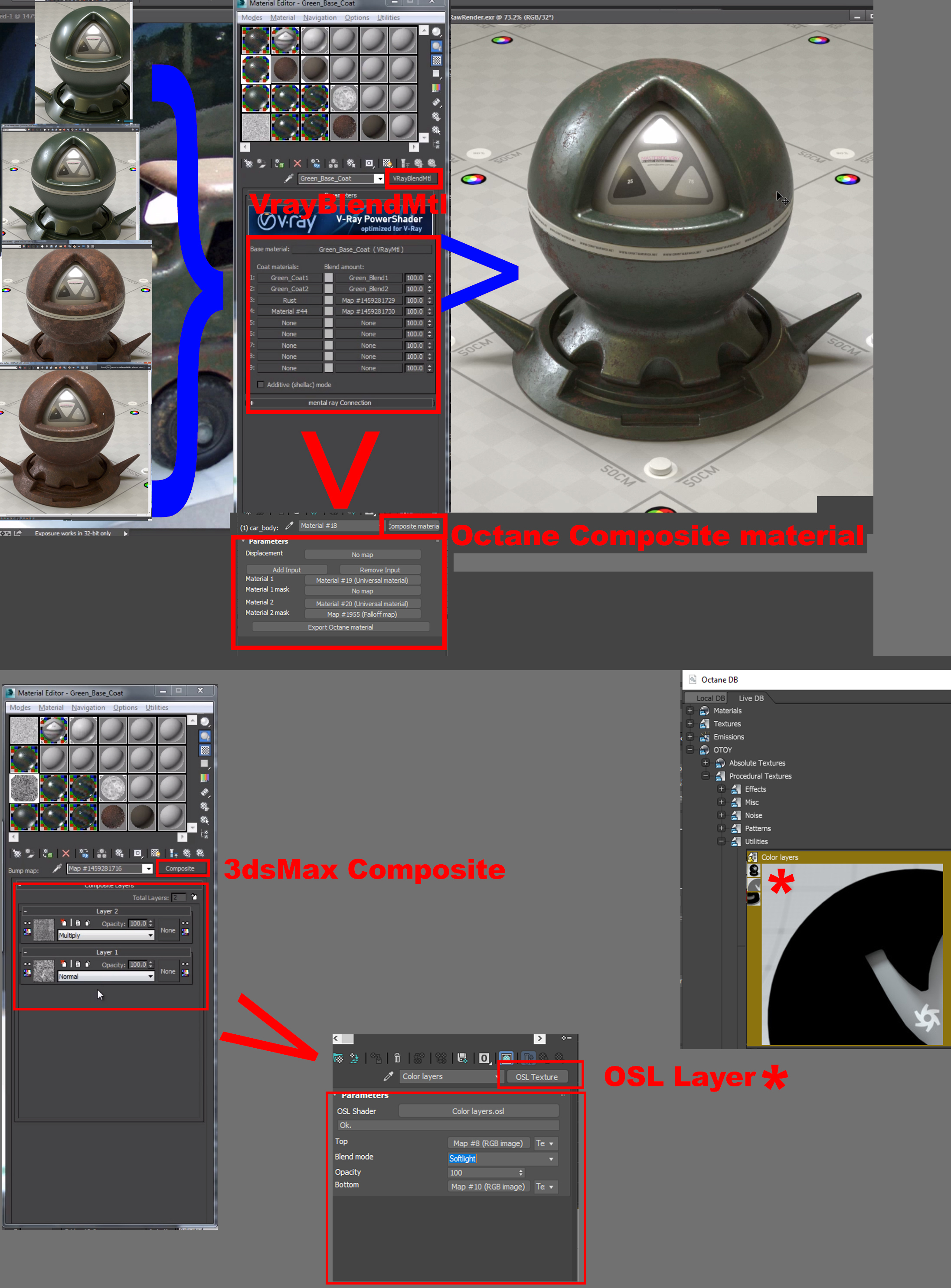

Hi guys,
here the workflow from Vray BlendMtl + 3dsMax composite to Octane render.
Regards
Paride

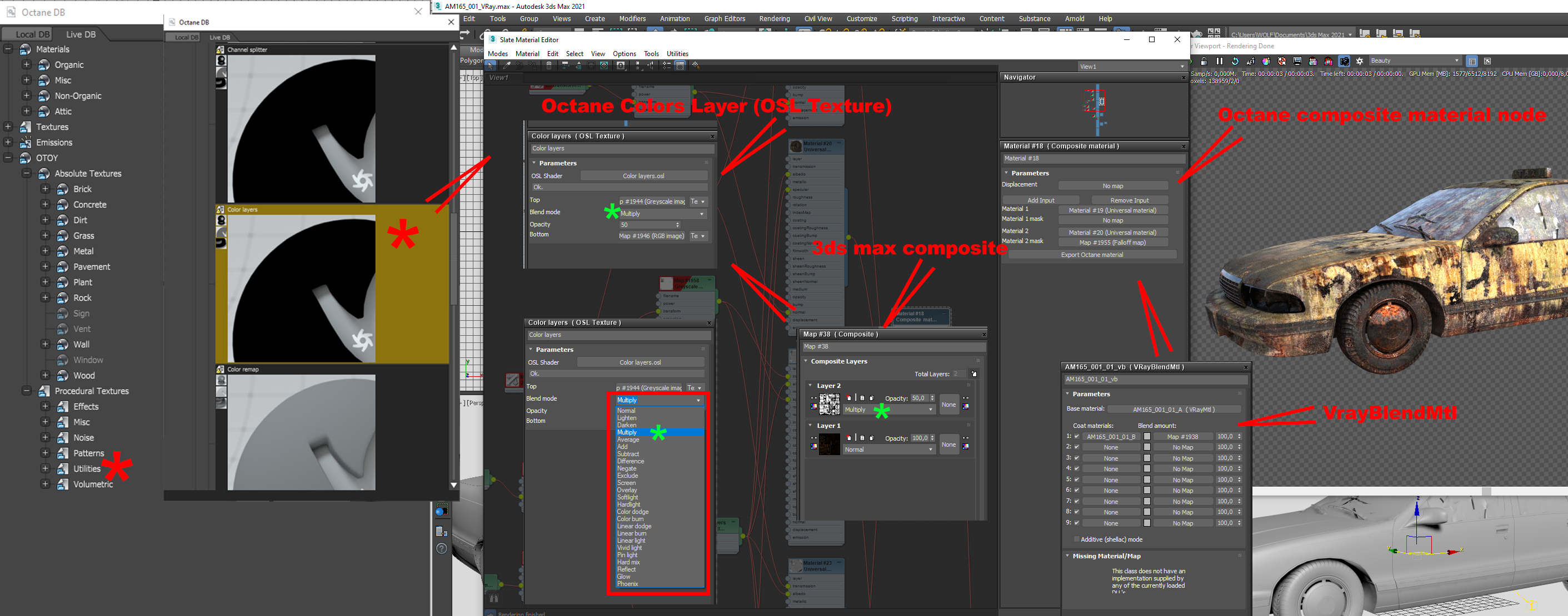

Hi guys,
in reference to this post:
viewtopic.php?f=27&t=56222&p=289365&hil ... te#p289365
3D libraries can be used with this materials and textures workflow.
We will soon have a composite layer node, in the meantime we can use this OSL layer texture.
Regards
Paride

Thanks Paride for the information.
I would like to know what is the mask tx #1 for , it seems no difference between there is or not a mask linked here
Supermicro 4028GR TR2|Intel xeon E5 2697 V3| windows 10| revit 2019 |Titan V+ Quadro GV100+RTX 2080 Ti
paride4331
Posts: 3997
Hi jimho,
it works adding a new material slot.
Regards
Paride
